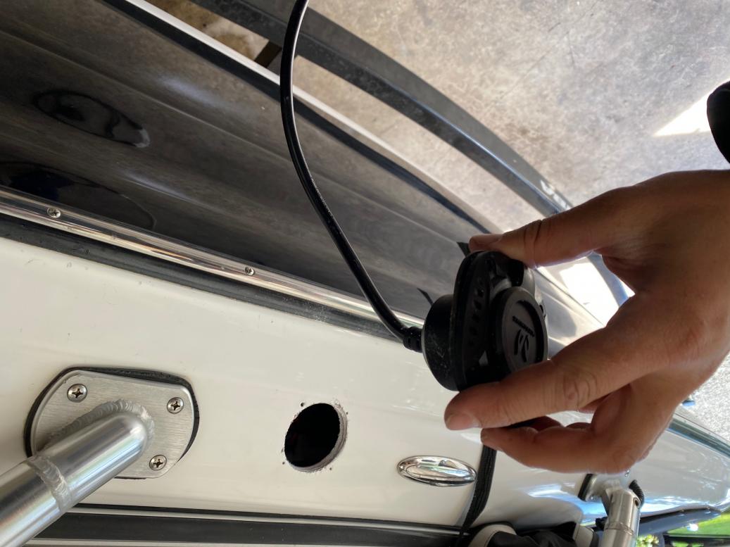

    ok, so I finally outfitted my 2006 Outback V with 4 batteries, (3 for the stereo, 1 for cranking) I went and bought myself a 2 bank charger from Pro-Sport and did not want to keep jumping into my boat to plug it in.
    so this is what I got: https://www.amazon.com/gp/product/B0...?ie=UTF8&psc=1

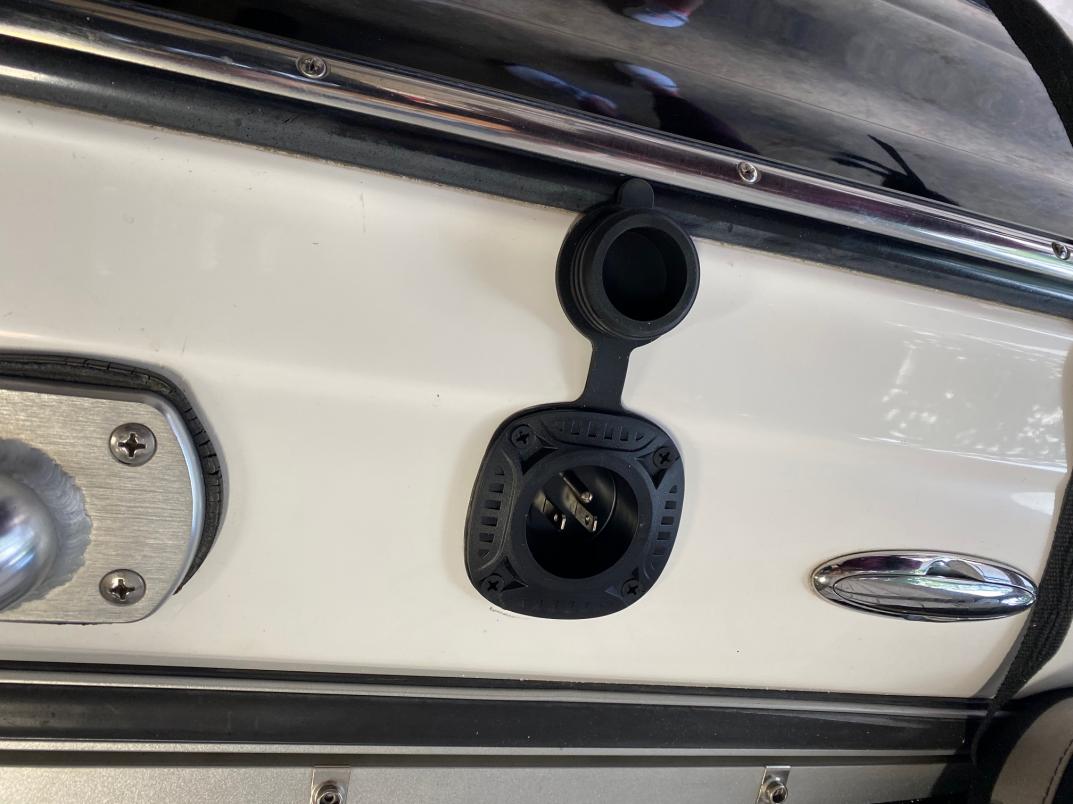

    it takes a 2" holesaw and it will be a snug fit. I used a small pre-drill for the screws and then chased them with sheetrock screws. (stainless thru bolts are next)
    here are the pics!
    this is by far the most loved mod I've done to my boat so far!
