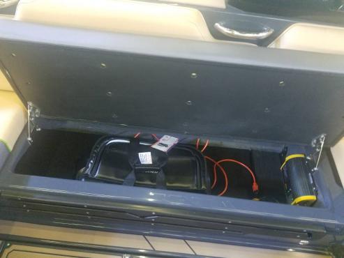

    Would like to add hinges to the larger seats in my Max behind the driver seat and same on port side. Curious if anyone has done this and what hinges were used. Pics would be great if you have any. Thanks

    Here’s one thread with them added along with other items
    https://forum.moomba.com/showthread....ghlight=Murder
    I would give these a shot if it was me though so the seat opens up towards you
    https://www.greatlakesskipper.com/sk...-inch-set-of-2

    Those won't work. Z28/MurderMax did it with those because there are no cross beams to attach those to. The port side lacks cross beams on both sides and the starboard side lacks a cross beam on the stern side.
    I believe he contemplated adding the cross beams to make it work, but ultimately went with his solution. I keep going back and forth on whether or not to add them as it is a nice solution....but I'm feeling like my boat will be a 3-4 year boat at most until I jump up in size and will just deal with the minor inconvenience. I only access them to let them dry out when being put up. If you plan on keeping it for any length of time, seems well worth the small trouble.

    I’m not sure if anyone answered your question but I’m interested in this as well. I would not want to have the seat open out like the example given shows but open up like a normal bench seat would. Hopefully the pic explains what I mean. I’d like to where to get these hinges as well.
