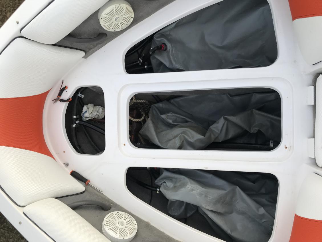

    I'm not sure if the bags/pumps have been upgraded. It did have two bags T'd from the front bag that took up all the front storage. I did not like that they raised the cushions up of the boat when filled, so I took them out.

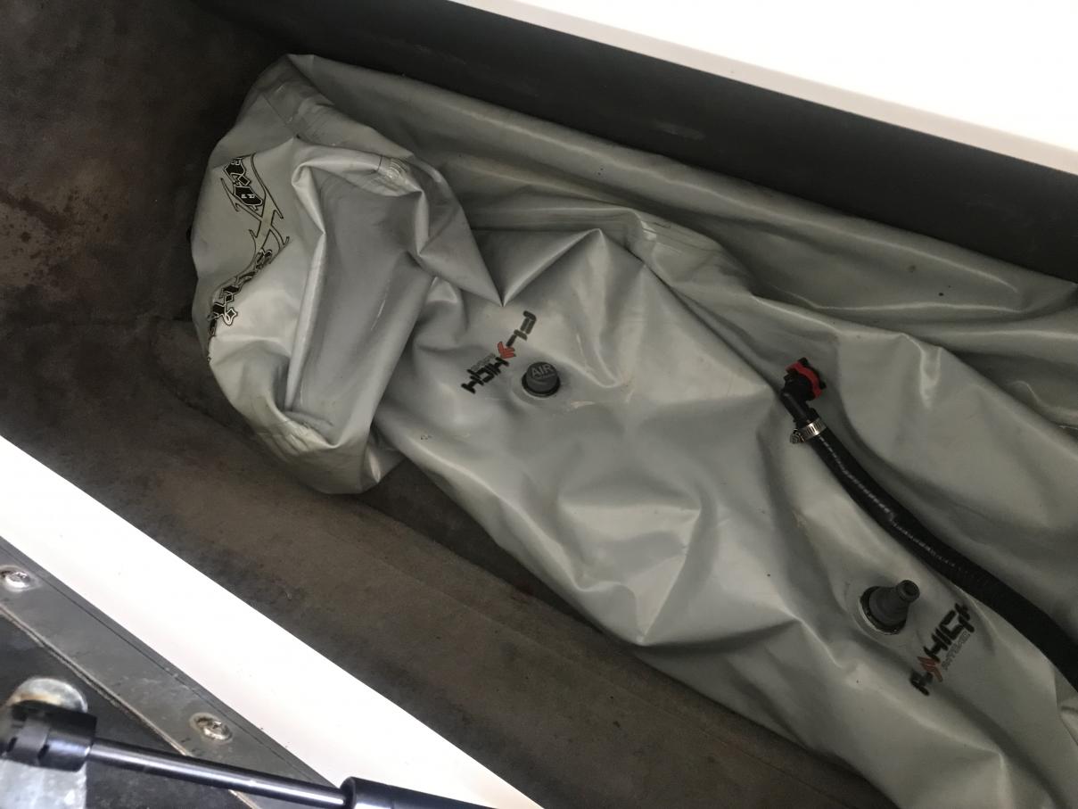

    Do these look like stock bags to you guys? I didn't want to call up wakemakers for upgrades until the sizes of these are confirmed. The closeup picture is the front center bag.

    My understanding is that on the Bags serial number the last 6 numbers indicate the Bag Size. On my boat a 07 Supra 21v it came stock with a 650 lbs front sack and 400 lbs sacks for each rear locker. The 400 lbs sacks have a serial number ending in 101670 or 10 x 16 x 70.
    From the serial number I see in your picture 191988 I think that is close to 1200 lbs. I'm not clear what came stock with your boat.
    On my boat I am running a stock front bag, 650 lbs, in each rear locker and a single gravity games front sac, 1200 lbs, up front. I also put a Fly High Pro X Series Center Locker/Rear Seat Sac, 650 lbs, on the rear seat and 3 Fly High Fat Bricks on the floor 155 lbs each.

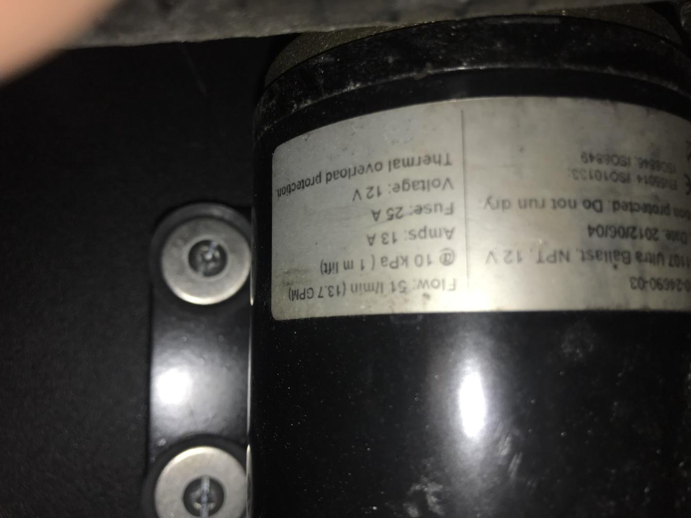

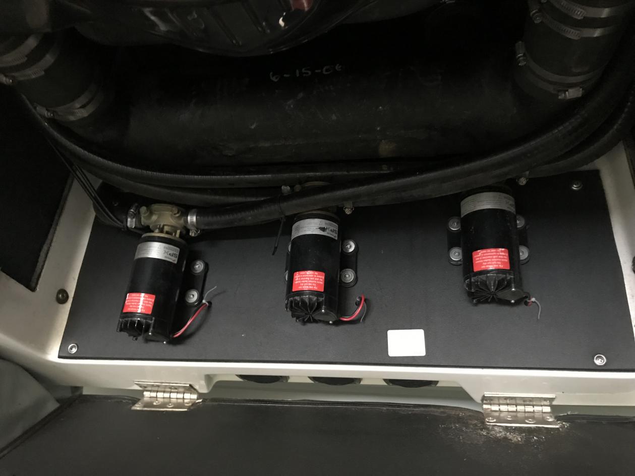

    okay, you scored! you definitely have the 1180 gravity games bag under the playpen locker. That's great.
    You've also scored in that you have the reversible pumps and it's been upgraded from the crazy slow OEM pumps.
    I would make a guess that the bags that are under your bow cushions that you didn't like are probably the old 400 bags that were stock in the rear lockers. Personally what I've done is taken one of those 400's and put them under my Port midship seats (from the cooler cutout to the battery box). most all of my friends and family surf regular, so port weight is key for us. I've taken the 2nd 400 bag and have it going from just forward of my battery boxes to the tip of that locker. It doesn't bow the cushion too bad. But then again, I put in a plastic ball valve from my local plumbing store that I can turn on/off the flow to my side bags so I can stop them filling when I want.
    For the rear bags, I have 1100's. You'd be great with either 900s or 1100s.
    For surfing regular, I run 400 under the surf side seats, 1100 port rear full, about 1/2 full in the starboard rear. 1180 full. And I get another 250 under that port bow seat.

    Measured the locker bags, they seem to match the 750# dims.
