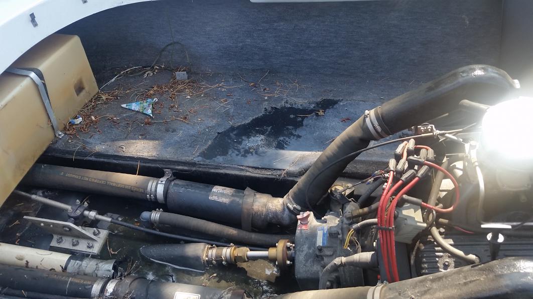

    Good timing. I just bought a new blower and the ducting from skidim as my 98 Mobius is mostly missing the ducting too. I am going to tackle this project next weekend. I see there are 2 vents up on the cowl where the ducting come in from and attach to the blower. I am not sure if the ducting attaches to the blower, or just ends near the blower intake. In the picture below you can see I have a hard white plastic tube with some duct tape on it. I believe the flexible ducting attaches to the tube (output from blower), which goes out to the transom.
    I also have those 2 vents on the rear of the dog house. I don't believe the flexible ducting attaches to them. I think they are for general air circulation, but not sure.20180828_105809.jpg

    The ducting goes under the floor and up behind the gas tank and attaches to one of the vent openings. I never had to mess with mine but I do know the ducting was not visible with the rear transom panels off. Good luck with the install.
