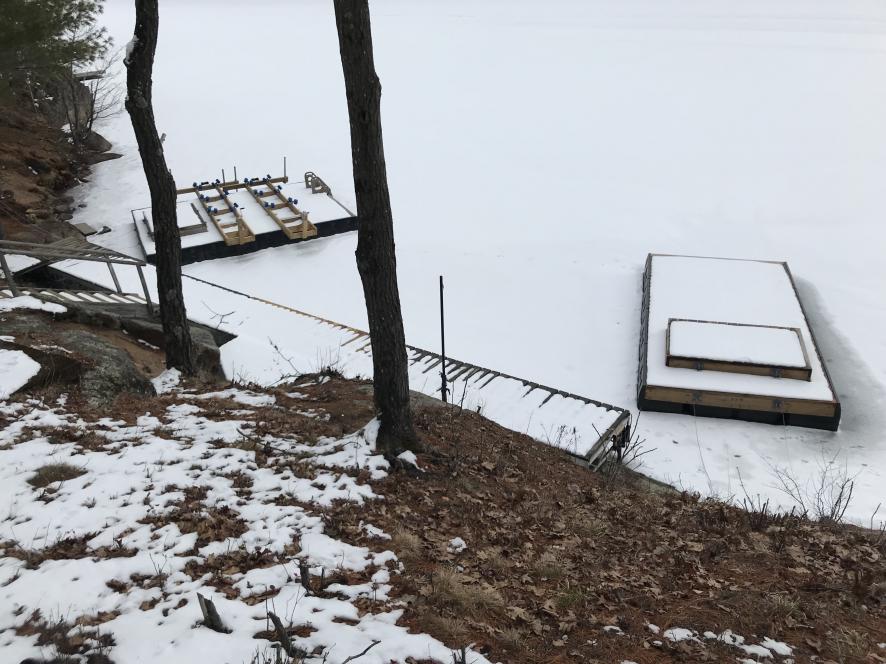

    I have floating docks at my cottage in Ontario that I am able to detach from the shore dock and leave in the lake every winter. I use a clothesline to secure them to shore and the concrete weights with chains hold them in the lake from moving around. I don't have the same length of dock as you do, but the same principle should work with multiple docks. We have had success with no damage to the docks since we put them in.
    I have a vertical lift for my boat, but I don't recommend this for you because of your unstable lake bottom. At one point I looking into pneumatic boat lifts:
    https://www.boatlift.com/boat-lifts/
    This might be an option for you.
