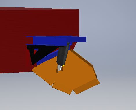

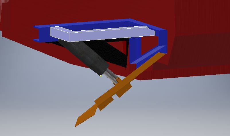

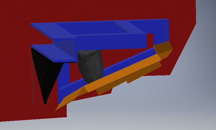

    I decided to go ahead and give it a try. Here is the design i will was thinking to install :
    Attachment 27988
    Undeployed it's -15 degrees and it will go up to 30 degrees fully deployed.
    I will be using the lenco 101 XDS actuator (already ordered) and i will be controlling this with an Arduino MEGA so i can hook it up to a screen and a GPS module. This way I can program some automation (auto retraction after X mph, etc.).
    Since i don't want to drill my hull, i will make an aluminium structure that will be attached to the swim plate brackets. My swimming plate is very low with all the extra weight i put in the back so i will use a 2'' Aluminium C beam to jack it up and i will also attach my surf tabs structure on it.
    I am from Montreal so i have about 5 months to get this done before i can give it a try so that should give me plenty of time.
    Any thoughts ?

    You're going to have to drill into your hull to mount the tabs, so why not a couple more holes for the actuator? It would save a ton of time and effort.
    It looks great, a lot like the Mastercraft tabs. That outward angle should probably make for a great wave, since you're getting a little tab effect, and a little gate effect.
    As I mentioned in my write up, I'd recommend tapping the hinge holes and use machine screws, not sheetmetal screws, unless you have access that you can through-bolt.

    Does your swim platform interfere with your wake?
