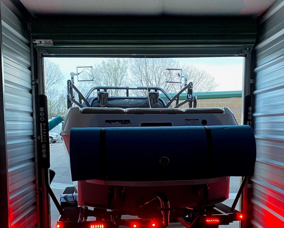

    This is the first hit I found on Google so I thought I'd add some measurements in case folks are looking for 2021 Max.
    It was REALLY tight in the storage facility I am using. The door width in the picture is 108" and height is 105 1/2". I had the tower folded and had to remove the racks after this picture was taken... then push up on the door to get that extra half inch. I can get measurements with the racks on and tower up and anyone is interested.

    Going to be that guy.....so glad I put 10ft wide by 12ft tall doors on my pole barn shop.
    The wife can even back the boat in with the tower up.
    Sorry...I had to say it. That is too close for comfort.

    Lucky guy! Pulled the boat out of the garage a couple weeks ago. Not only was it tight going in (an inch or two on either side through the door) but it was tight coming out! Hit the wall with the corner of the trailer. Nothing a drywall patch won't fix, but I also need to get adhesive for the reflector that popped off too! Looking for a new house now and the garage is my #1 priority. The kitchen is tops for the wife though. If we don't find something we like soon though, I may have to just add a new garage to the current house.
