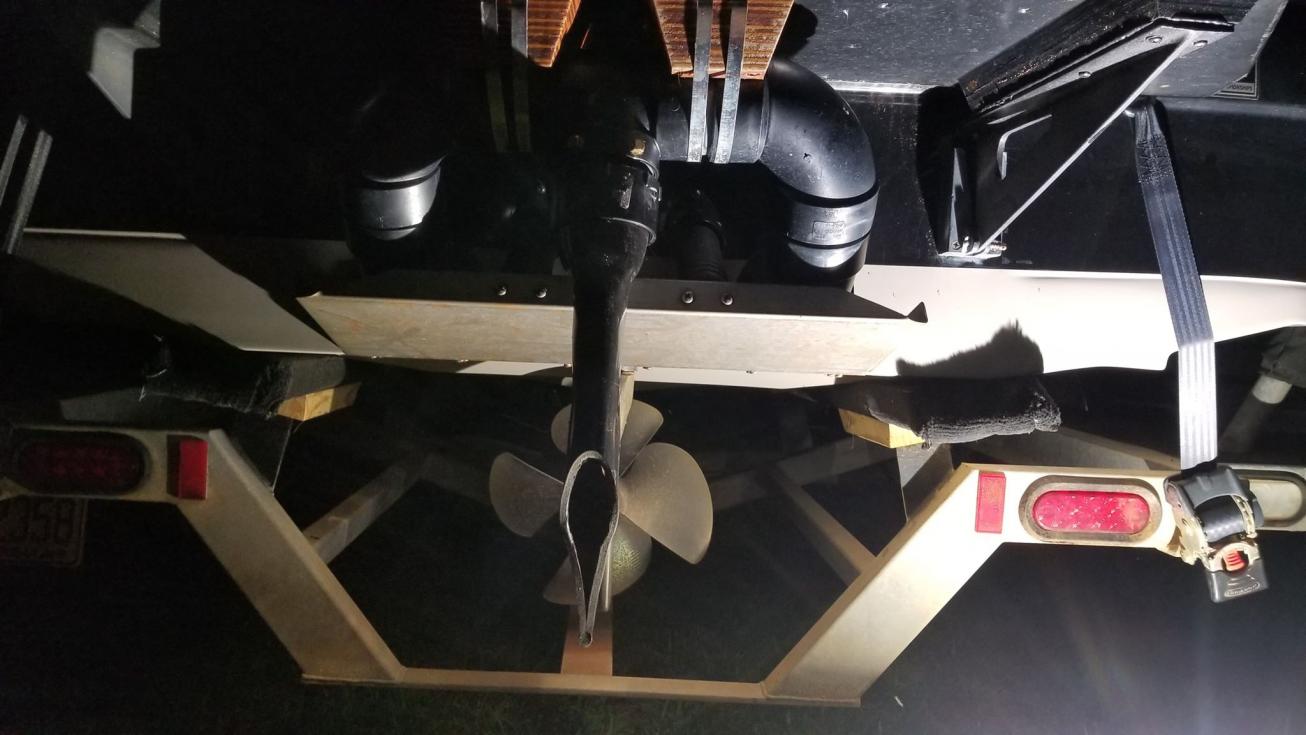

    I suck when it comes to updates on stuff like this. Forgot that I hadn't uploaded anything since the 'teaser' photos... sorry!
    It has been used now for a season and a half now and I have no complaints. I have lost 1 downtube and had to remake one. Seems to not like the threads in the cleanout tee, the first one unscrewed in the propwash, the second pulled the threads out and broke the male thread fitting. My third one was the shortest Z dimension of all of them (still works as supposed to). I don't think it enjoys crabbing sideways with the surf gate on, it definitely acts as a fixed rudder.
    This is an old picture, need to take a daylight one of the latest version of the downtube, glued via threads.
