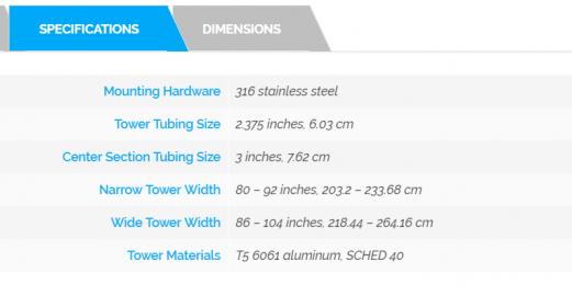

    Hey what diameter tubes are used on the Moomba towers? Are they all the same size or are there different sizes? I'm working on a project that I am hoping will work for the Moomba towers, but I don't have access to a dealer around me. I am mainly looking to the cross tubes overhead. If anybody can take a caliper to theirs and post their model of boat and the result I would appreciate it?

    I’m not looking for my boat. I am trying to find out what clamp sizes I would need to fit the most boats. If you know your size , can you post it with the year and model. A pic of the tower with the specs would be awesome too.

    I think he's working on a "project" for multiple towers. I wanna say the older LSV tower (XTP one from 2006-2010 or so) was 2 3/8" (2.38"). The ones before that were smaller.

    I'll check my 2014 Mondo with Oz tower later today.

    2017 Craz with Roswell A3 Aviator tower

    2015 OZ HD is 2 3/8. Roswell has a universal clamp that has multiple size inserts. Wakemakers offers them.

    2014 Mondo Oz tower is also 2-3/8"

    Thank you guys. This helps me quite a bit.
