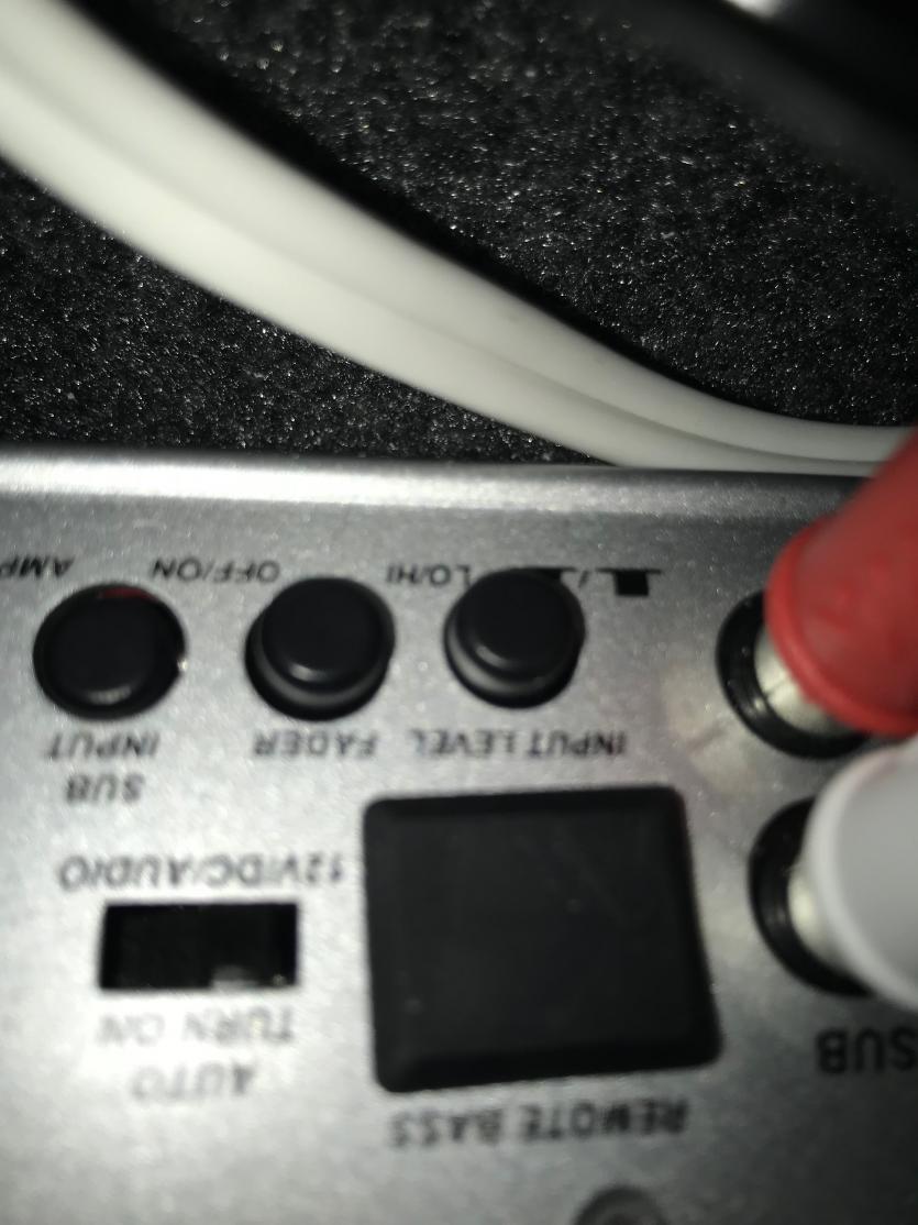

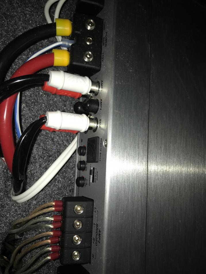

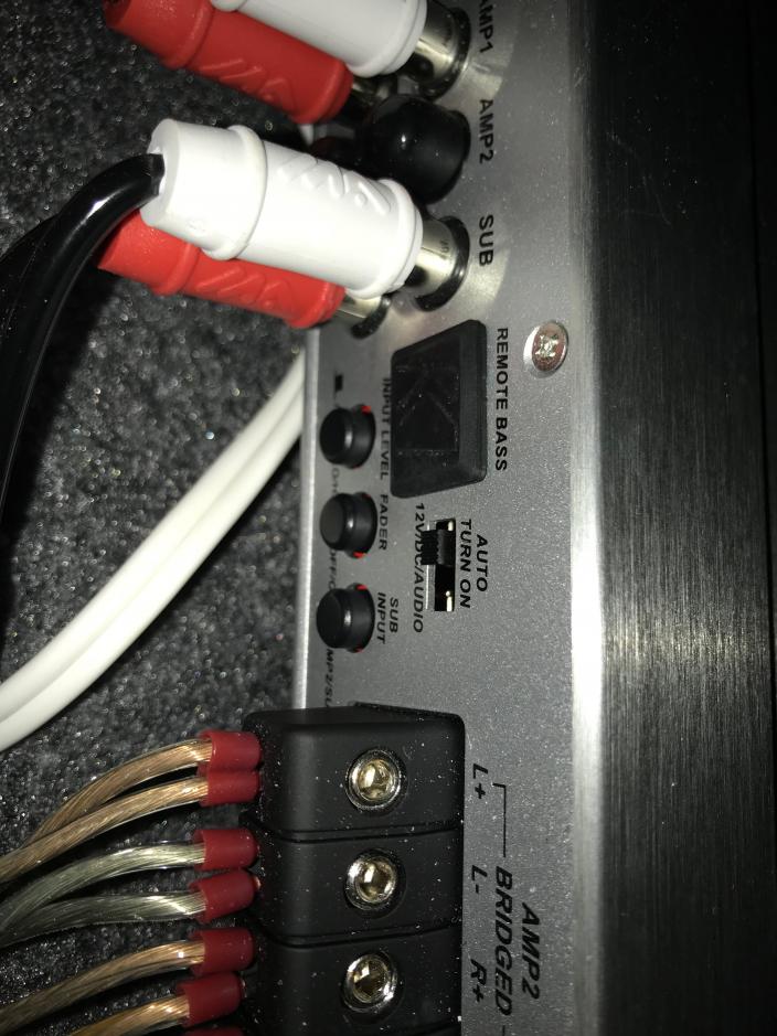

    My stock sub stopped working at one point last season, technical me pushed a couple of buttons on the Kicker amp and it started to work. It wasn't working again at the end of the season and at the current moment my stock sub is not working.
    Could someone please let me know what position the buttons and switches on the Kicker amp should be in? For reference I have attached pics.
    The Sub Level is all the way up on the head unit. Also what should the 'Sub Filter' be set at? 55 Hz? 160 Hz? What difference does the hertz setting make in performance or sound?

    In your application, the "sub input" would be in the in position. This receives the audio signal from the Sub RCA from head unit. Out just gets the signal from the in-boats RCA and should also work. If neither position work, the amp chnls is down, the wires to the woofer are disconnected or the woofer is bad.
    On rare occasions, corrosion in a switch can stop a speaker(s) from working and exercising the suspect switch can make it work again. Other wise, switches and setting would not cause it to stop working on its own.
    If the issue is intermittent, move the switch to out and run it for a time. This eliminates the RCA and head unit sub output.
