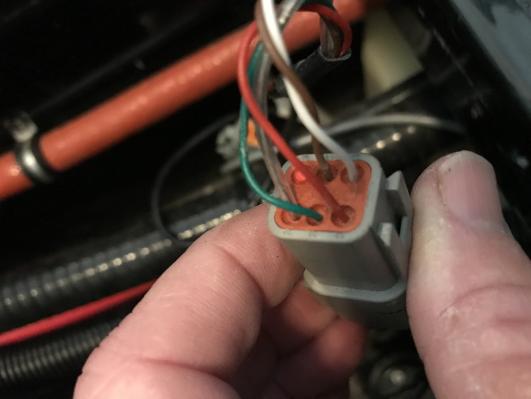

I have a 2014 Mondo and I'm trying to install a Nautic Laugic GPS unit. Where the paddlewheel connector is supposed to be, my wires appear to be spliced.
Anyone with a 2014 Mondo, is this how yours are, or do you have a connector? If they're all like this, then I must be looking in the wrong place for the connector.2019 Supra SL450

That is not a shrink wrapped connector. It's too small. It should be roughly the size of the gray one shown there.
Here are the male and female connectors of the GPS unit.2019 Supra SL450

It looks like the cable was cut and butt spliced back together.

I installed this on my 14 Mondo. The only thing the paddle wheel is used for is water temp. It is the brown and white wire. 6088EBCC-7711-4FC5-AF91-0E6030D9DEE5.jpg0C22AAF3-B938-4560-8762-4F2A74C5B33C.jpg
