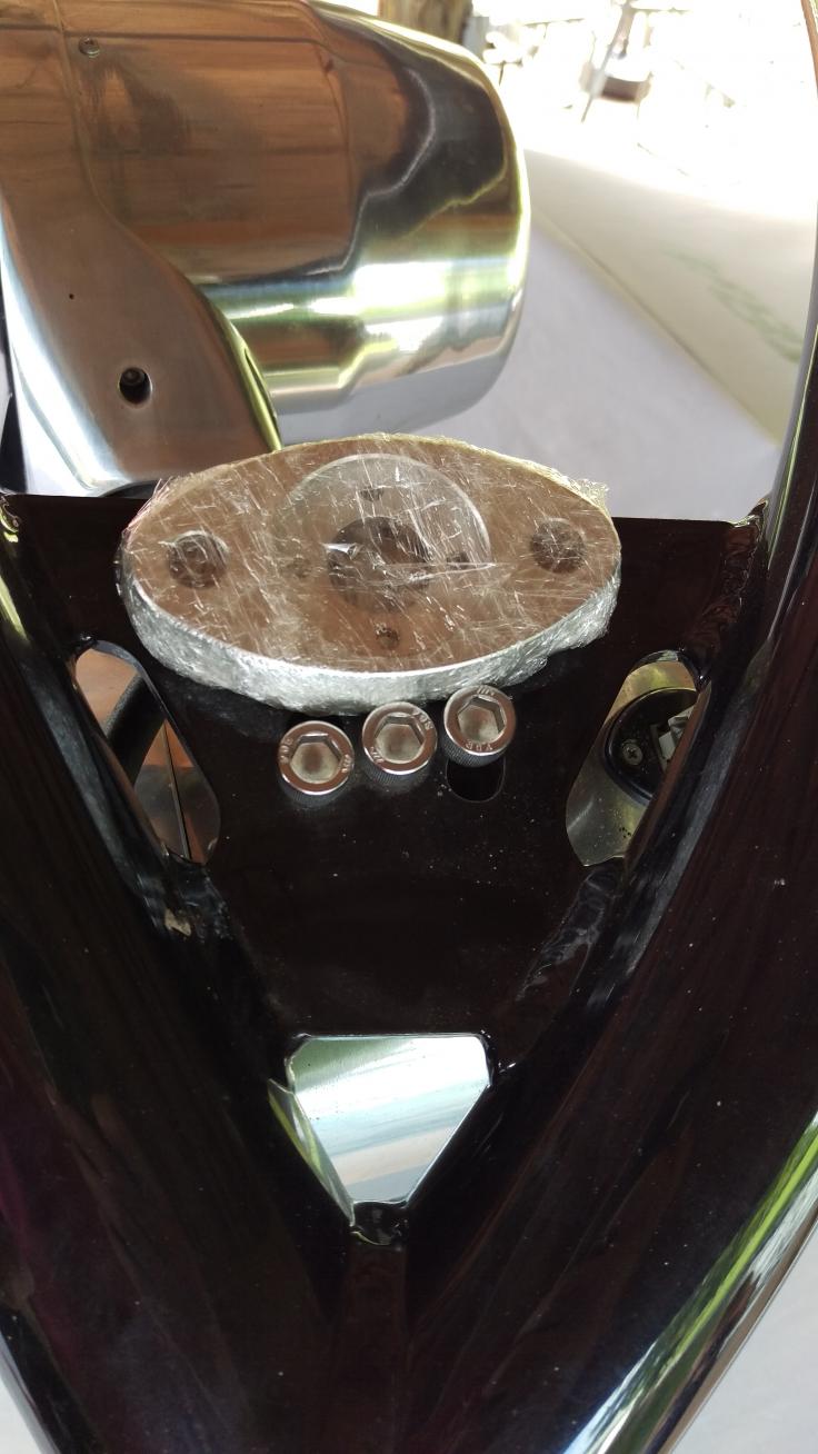

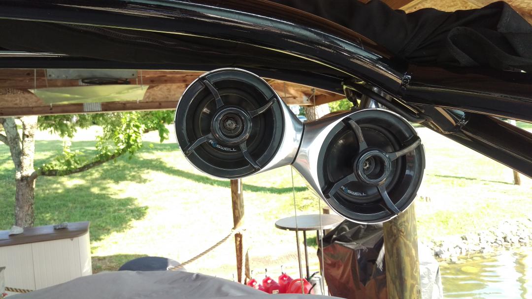

Got the cabin, sub and amps done last night, didn't run into any real issues other than the factory speaker wire not being long enough in a couple places. I am debating on how to mount the xm9's. The current tower speakers are the Roswell 4 speaker combo spinners mounted to a flat plate on my 2015 Mojo with the OZ HD tower. Do I drill new mounting holes there or drill the tower and use the big clamps?

That's a difficult call without pictures of the bar your referring to.
Also I would need to look at my XM9s to see how they would munt to a flat bar.
The Roswells should resale easily with everything included, a lot of people love that particular combo.

I have only found 1 picture online that shows the plate I am referring to, and its really hard to see it, I just know what I am looking at. I will post up a pic when I have my phone later. The exile clamp assembly comes apart to be able to mount to a cast tower, I am thinking that is my best option. I have all my stuff for sale in the classifieds that I removed, so far only the cabin speakers have sold.

Here is how the current towel Roswell speakers are attached to a flat plate and though bolted, the wire for the plug comes out right at the base of that plate on the bar.2018 Supra SA400 aka The Ron Burgandy
