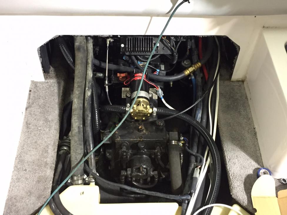

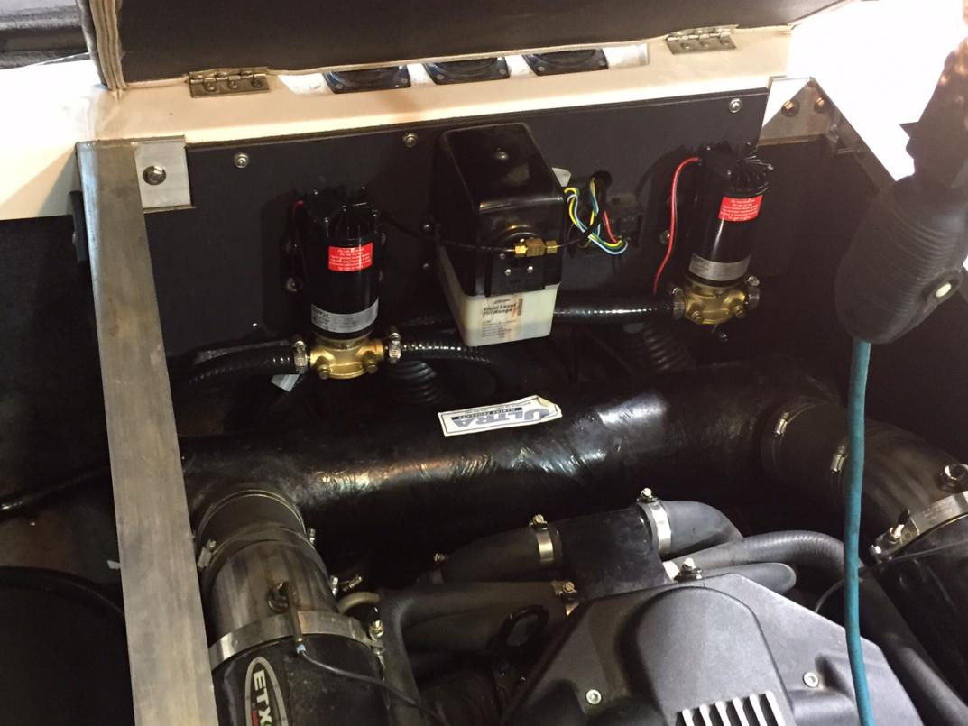

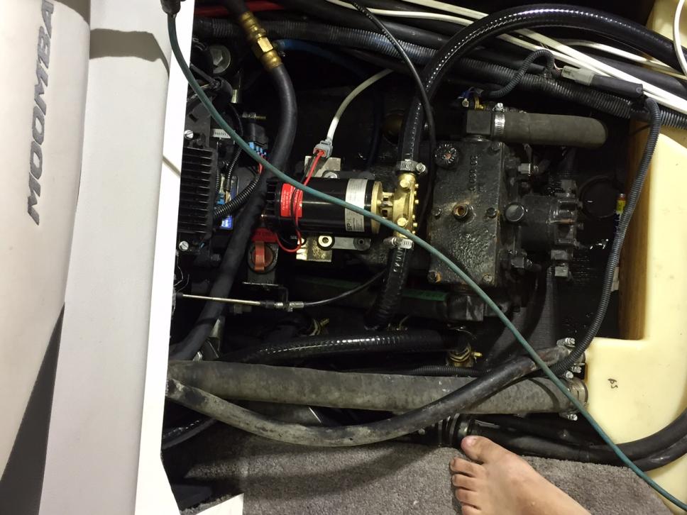

    Welcome to the forum, there is a wealth of knowlege here! As for the upgrade you will absolutely love it, i just did mine this year with the whole kit from Wakemakers. If you have any questions about anything they will walk you through it step by step, they are awesome to work with. Here is a link to a thread that has a lot of info on the upgrade; https://forum.moomba.com/showthread....allast+upgrade I put all 3 of my pumps in the engine compartment. One on the wall just behind the back seat (right about the transmission), the other two i put one on each side of the engine on the black seperating wall just to the left and right of the transmission (not the panel that folds down but the small piece just in front of it) I don't know if that makes sense.

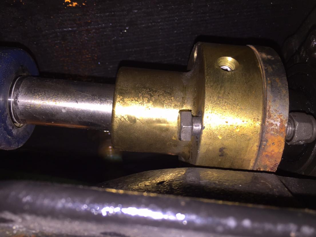

    One thing thou when I was pulling the old drain pumps found a fine thread bolt and two nuts. After some investigation I found the shaft connected to my drive had only 2 of 4 bolts in and the 2 in it were loose. I guess the 1000.00 ballast upgrade might of saved me some loot if that blew apart. Any one else had issues with these bolts coming loose?

    Yes, these bolts coming loose are fairly common and its something that needs to be checked at least once a year. I would put all new hardware in if I were you.
