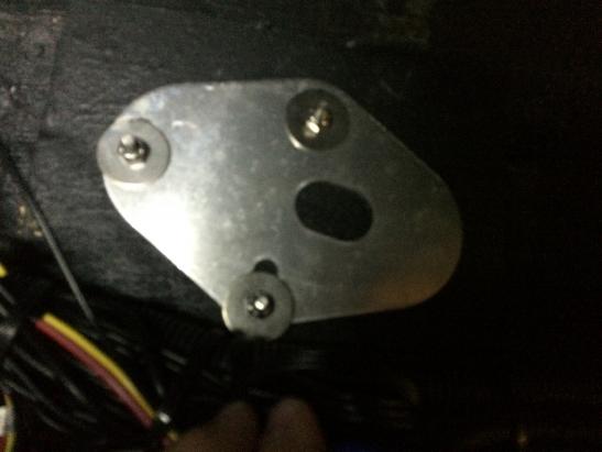

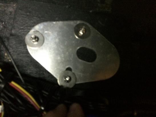

    All the speaker wire was run in the tower according to the "how to" on the forum. A slight snag was the tower foot on the 2010 was a little different than earlier models and we had to pop off the left side of the tower so we could fish the speaker wire down into the amp area.
    We drilled up from the bottom where the lower support plate is. There is an oval cut out between the two side bolts, but this did not line up exactly with the center hole coming down from the tower (See pic). Also note while wiring the tower, I had a reel of electrical fish tape (spring steel) that came in quite handy through the process.

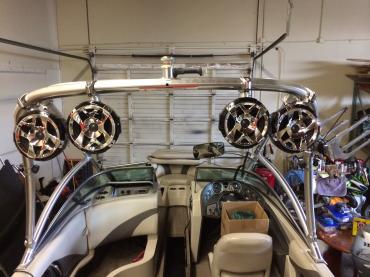

    Tower speakers mounted

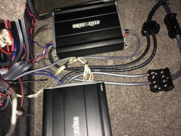

    Amps mounted (2010 came with an amp board mounted for the Kicker system)
    Wired amps - Power/Ground/Speakers

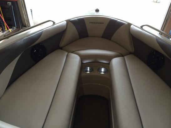

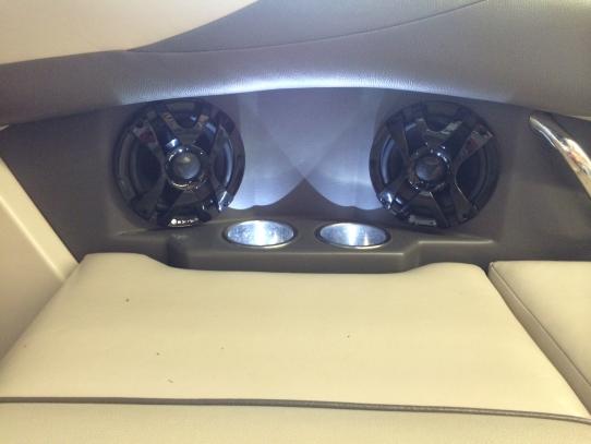

    6 cabin speakers swapped out

    Speaker wired attached to the amps
    Remote wires attached to the amp

    Ran into a quick issue with the cabin speakers and needed a Y connector to run the bow and main cabin
    Battery #1
    Starter
    House fuse and items
    G3 Ballast
    Battery #2
    Complete stereo system (Head unit, Amps)
    The sound compared to the Kicker system is, well... there is no comparison. I did not add a sub (yet) and do get some good bass out of the cabin speakers. Brian and Mike convinced me I will want a sub, part of why I prewired all for a sub. Likely something I will do in this next off season.
    I have the Fossil / Sand color combo and the black Exile speakers look great. Good contrast.
    We were able to mount to the tower and still have room for the Z5 with some head room to walk under.
