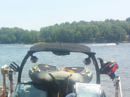

    I'm having the same problem with my Mondo '14. If you put the rope over the bimini, it seems to pull down on the top, if you have it under, it clearly rubs the stitching as you cross the wake. I chose the latter as it seemed to be less damaging, albeit unnecessary. I also had trouble connecting it the first time with the straps, but after some steady pulling we got it the stretch out and be a non-issue. I've posted a pick of my top open looking towards the stern, and you can see it curves upward and the rope would put serious stress on it the frame of the bimini top.
    any suggestions?

  4. #24
    Jul 2014
    Northern VA
    86
    forgot to add the pic

    Quote Originally Posted by WhiskeyRunner View Post
    Your bimini looks too loose. When I pull the strap down I have to pull the bimini down slightly with one hand. The fabric should to tight.
