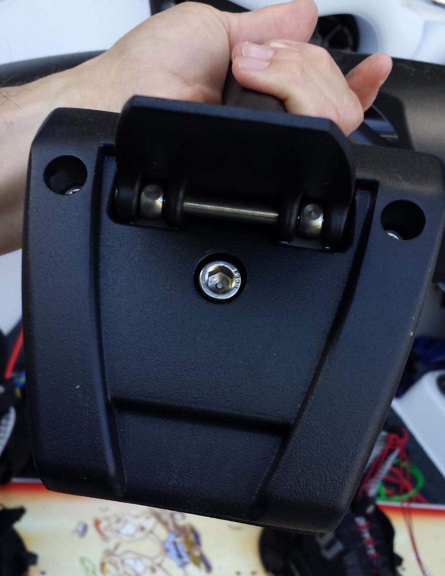

    On mine, it does not seem to be tightened by hand. it attaches to the window frame with a hex bolt. I will take it all down tomorrow and let the forum know. thanks

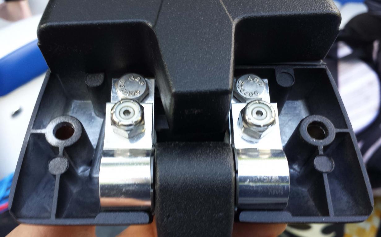

    So if you unmount the mirror, and remove the two set allen-head screws, there are two nylock nuts inside that tighten the mirror arm. Pretty easy adjustment. Seems to be fine now.
