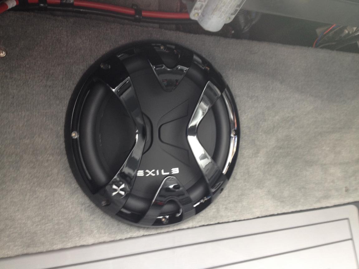

    I will warn anyone wanting to use this design... it's tough to get the sub in... I had to remove the footrest screws and push it back an inch or so. Once I got it in I could put it back in position and now it looks like it came from the factory that way

    Can you tell me where the footrest screws are located?? I don't have my new Mondo yet....so I can't go and check.. Thanks

    Two under the cup holder, just pull the metal cups out. And then two right in front of the captains seat (you'll see those as soon as you pull up he carpet.

    Got the sub in on Friday and had a chance to do a rough tune... system sounds great! I trimmed back the carpet a bit around the opening and installed some weather stripping on the sub flange to seal things up good.
    Hopefully we can get out on the water and put the system to the real test soon!
    Thanks again Brian @ Exile!
