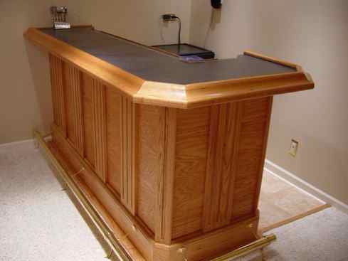

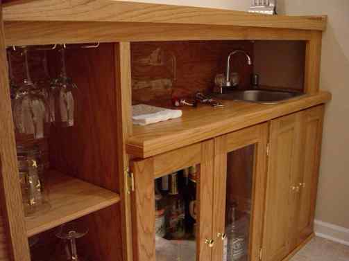

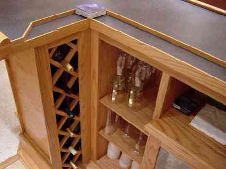

    Looks great and will last a lifetime -- much better than anything you could find in a store. Not to mention the pride you taking in making something of that kind of quality!!
    If I may brag for a minute....I spent several months planning and building a bar for my basement and it still looks great some 10+ yrs later. All hand made including the oak bar rail which was a real bitch.

    That is Gorgeous!!!!!! I love the built-in sink and the stemware support....

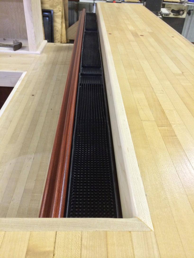

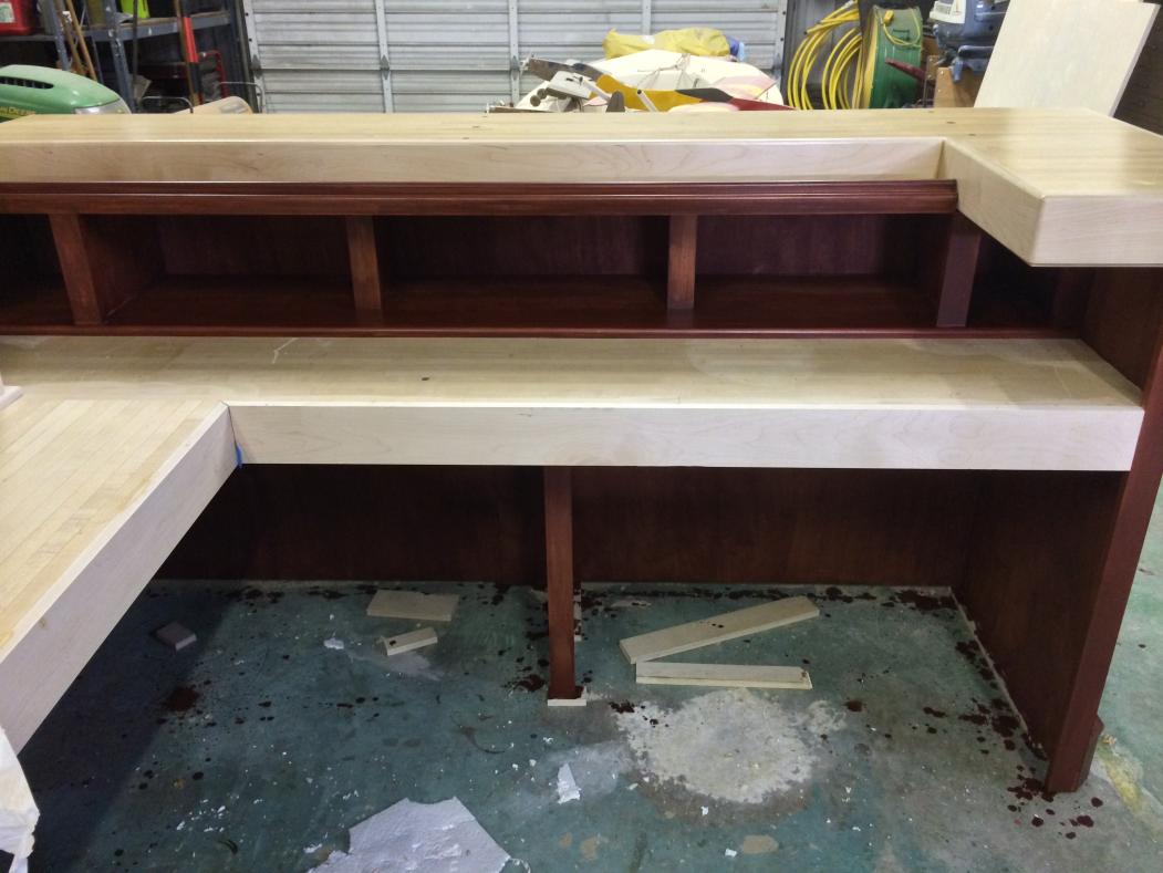

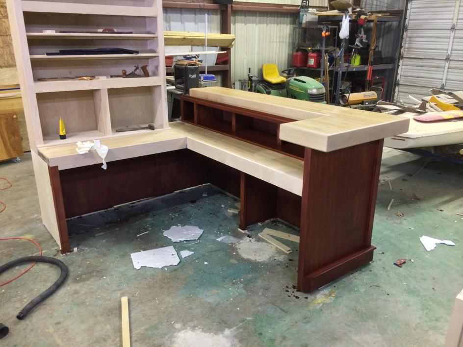

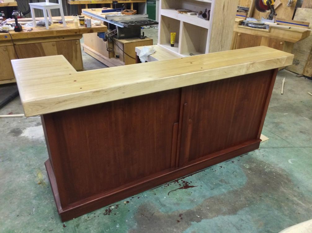

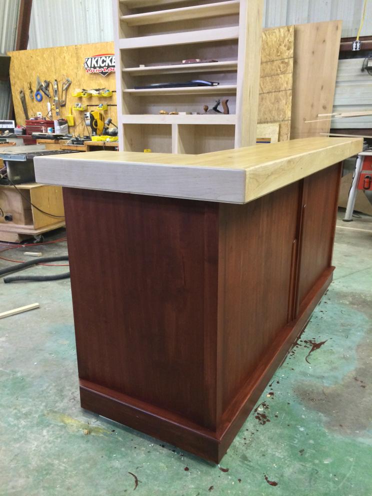

    Staining and sealing have started. I still need to finish molding the edge detail on lower bar surfaces before they get sanded and sealed. I need to stain and seal the uppoer cabinets too, then stain and seal the equipment racks, (not shown). Still a ways out but the pics here show a good representation of what it will look like.

    Ugh.....always loved the building but hated the finishing......as expected it looks awesome!!
    How many coats of poly on the top?

    4 so far. I am a wood boat restorer on occasion, so I am used to taking a month to get a good build, (20 coats) of exterior UV boat show varnish. I am pickey.... The wood boat experience has taught me some things to do to speed up finish work. Rolll-and-tip is one trick. Us a small foam roller to quickly get your finish material on , then just drag a wet brush through it to remove roller texture and bubbles. You can put a coat on this bar top in about two minutes in this manner....
    I am using something different here, based on some preliminary samples. Tests so far tell me it is really a good product for this application. I am using a water-based polyurethane from Rustoleum... I have a UV radiant heater in my shop. I am able to bring the wood up to a temp, then shut the heater off while I am applying the finish. Turn the heater on and in about 20 minutes it is ready for over-coating...
    Easy easy east easy.... I was concerned I would not get a build of material that gave the top that deep water-soaked wet look but I am wrong. The grain is popping already with just 4 coats and shows a lot of depth contrast from board to board.
    The build is thick enough now for a scuff sanding to flatten the high spots. Then 4 more coats and I will see where things are. At this point I am not trying for a thicker coating, as I think I already have sufficient build thickness. I am looking for a flat coating; one that doesn't have the grain texture telegraphed through as microscopic high and low spots. The sanding after these 4 coats will tell me how flat and filled the grain is after these coats. It is Hard Rock Maple; I really don't think it will take 20 coats like that porous old teak and mahogany we work with on boats....
