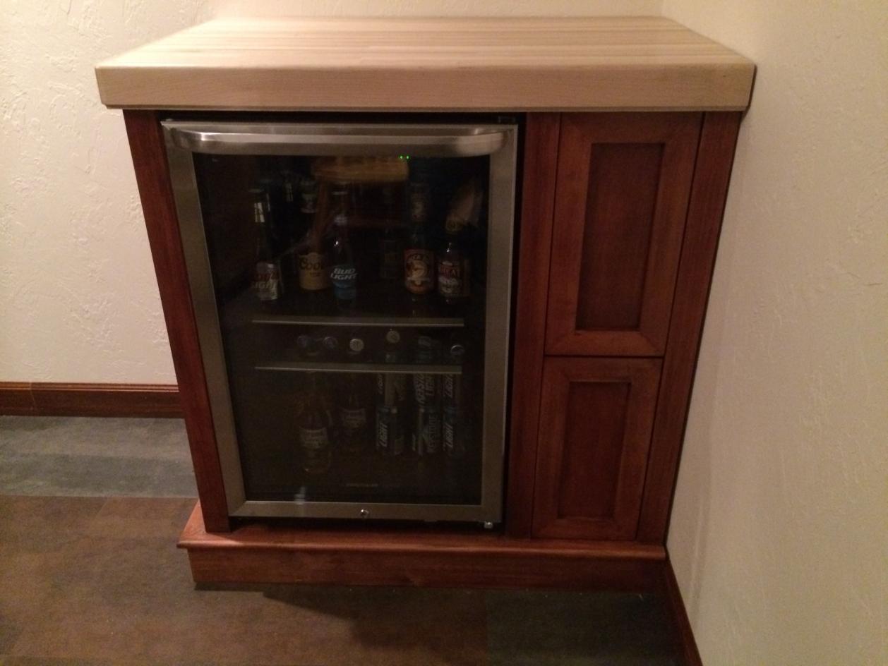

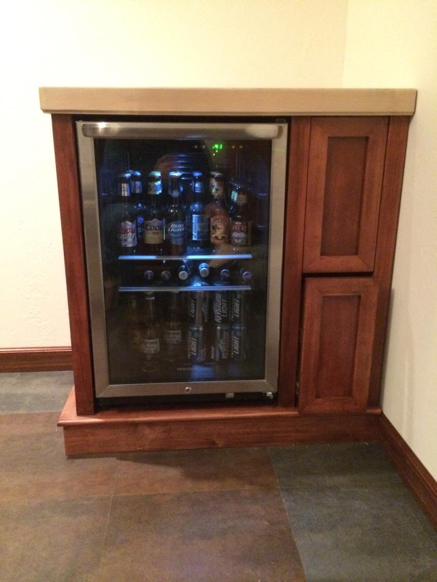

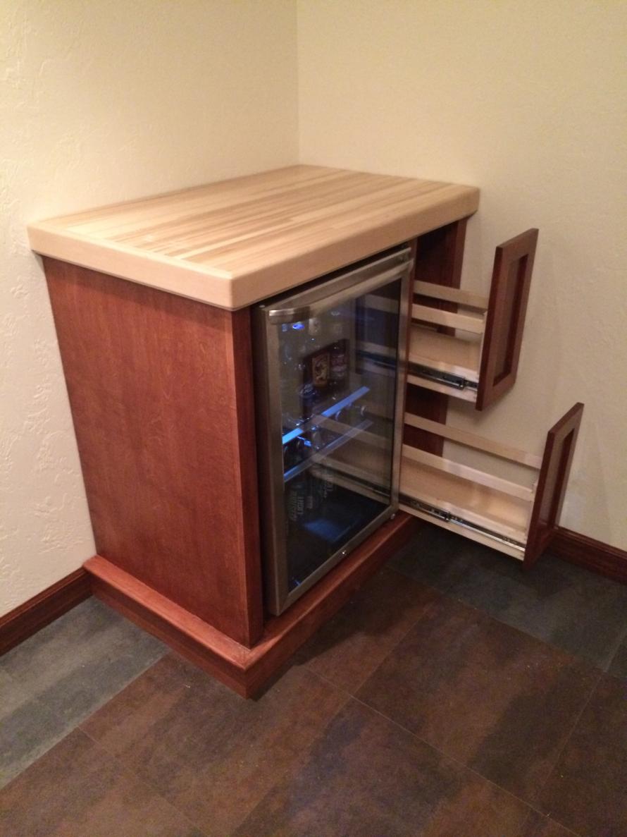

    ALMOST done with this piece..... I got the beverage cabinet into my office and put together last night. I still need the drawer pulls installed but they are on order. Brushed nickel ones that very closely match the fridge handle.
    Time to switch gears and get going on the actual work/play bar...

    Looks great, nice job!!

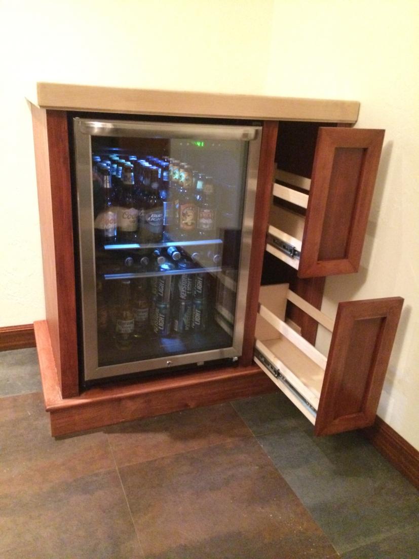

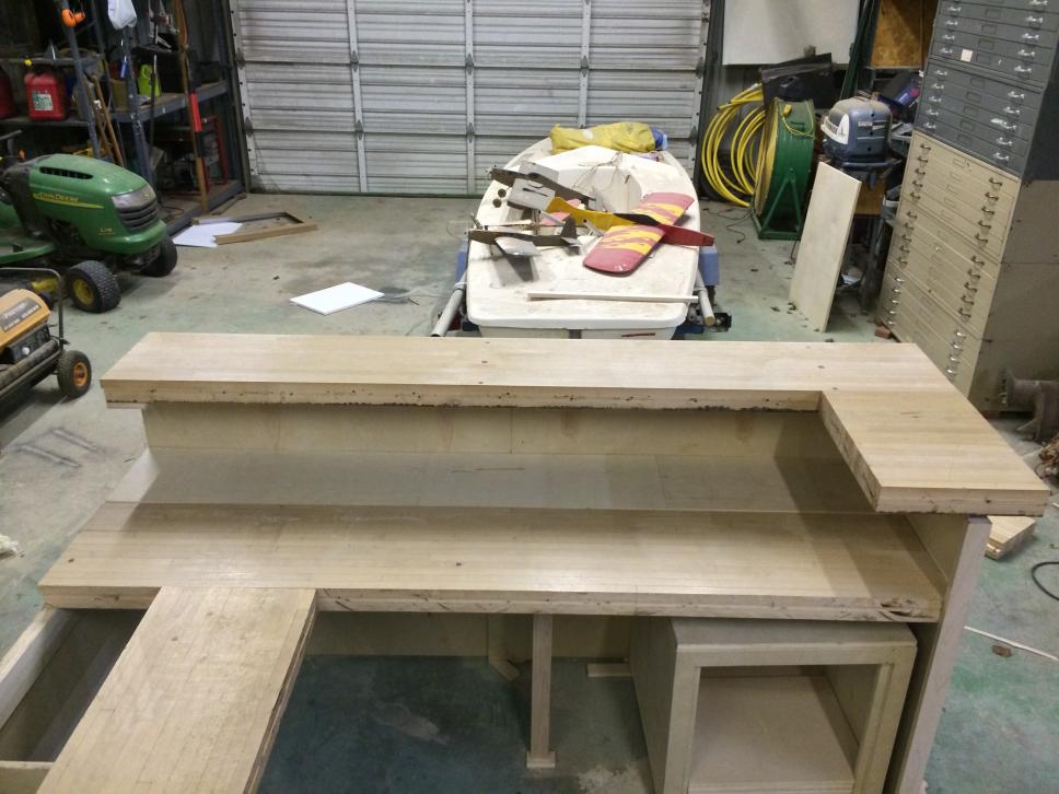

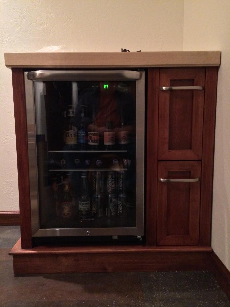

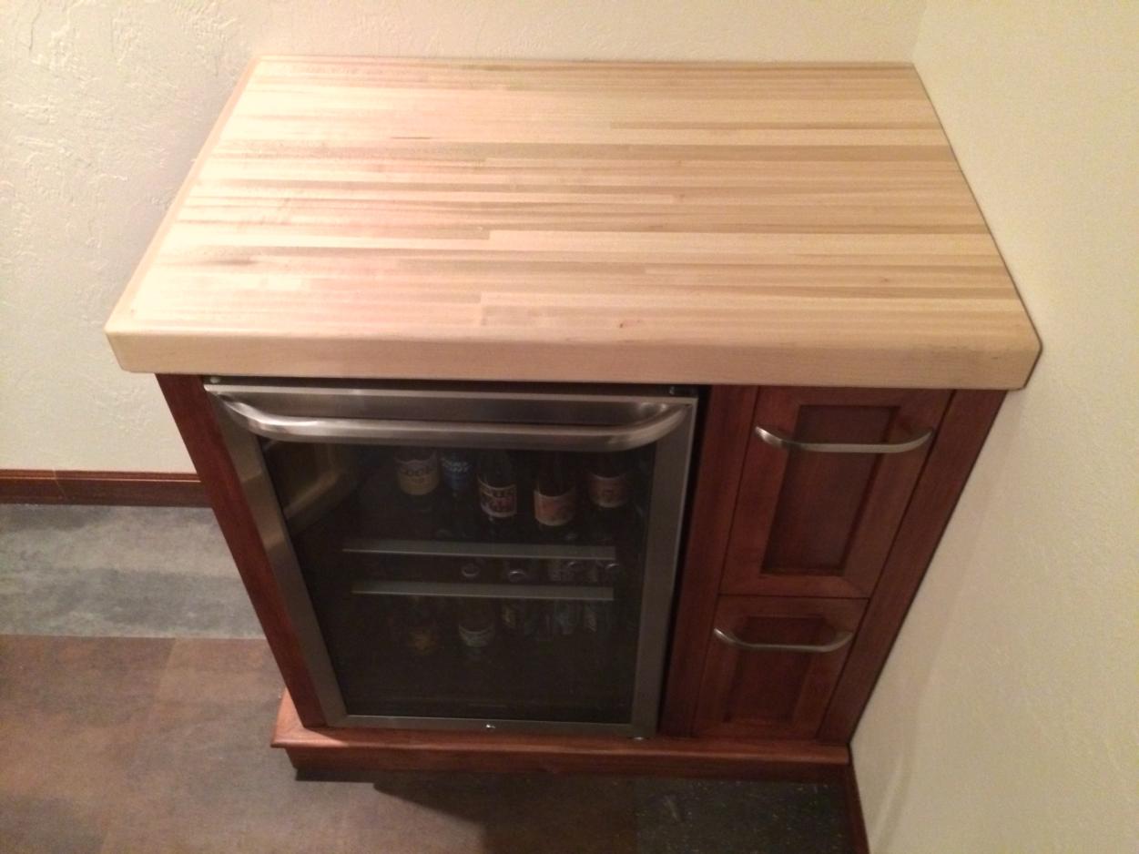

    A few updates:
    I got the drawwer hardware in and installed. These go quite well with the fridge handle.

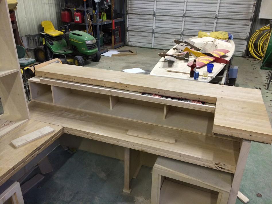

    I am also starting in hard-core on the desk/bar area. You guys considering using bowling alley wood for tops, know the stuff is NAILED together and not glued. I learned that you need to use a demolition blade on the stuff, and even a demo blade wears out quickly.
    I got enough bowling alley surface to at least get 13" of width on each of the three surfaces. This should go good now that I have the bowling alley blanks finished cut. 'Took three days of careful planning and prep to split and then crosscut the stuff. This stuff is nasty to work with as the back side is coated with creosote.
    Here are pics of the finished beverage center and the progress on the bar/work area....

    Outstanding. Just outstanding. Takes a brave man to work with hardwoods. We aren't worthy.

    Phhil - Super nice! God I wish I had the time to be in the shop. I used to before 3 kids arrived. Bravo to you Sir!

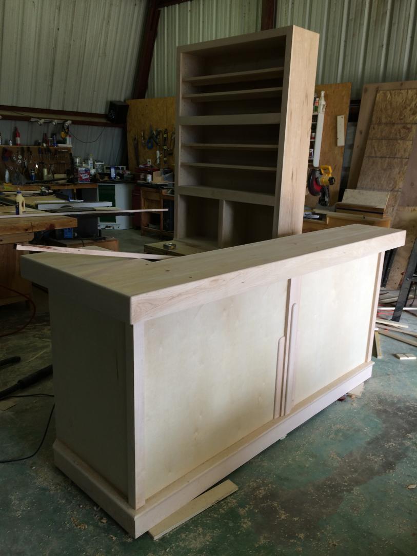

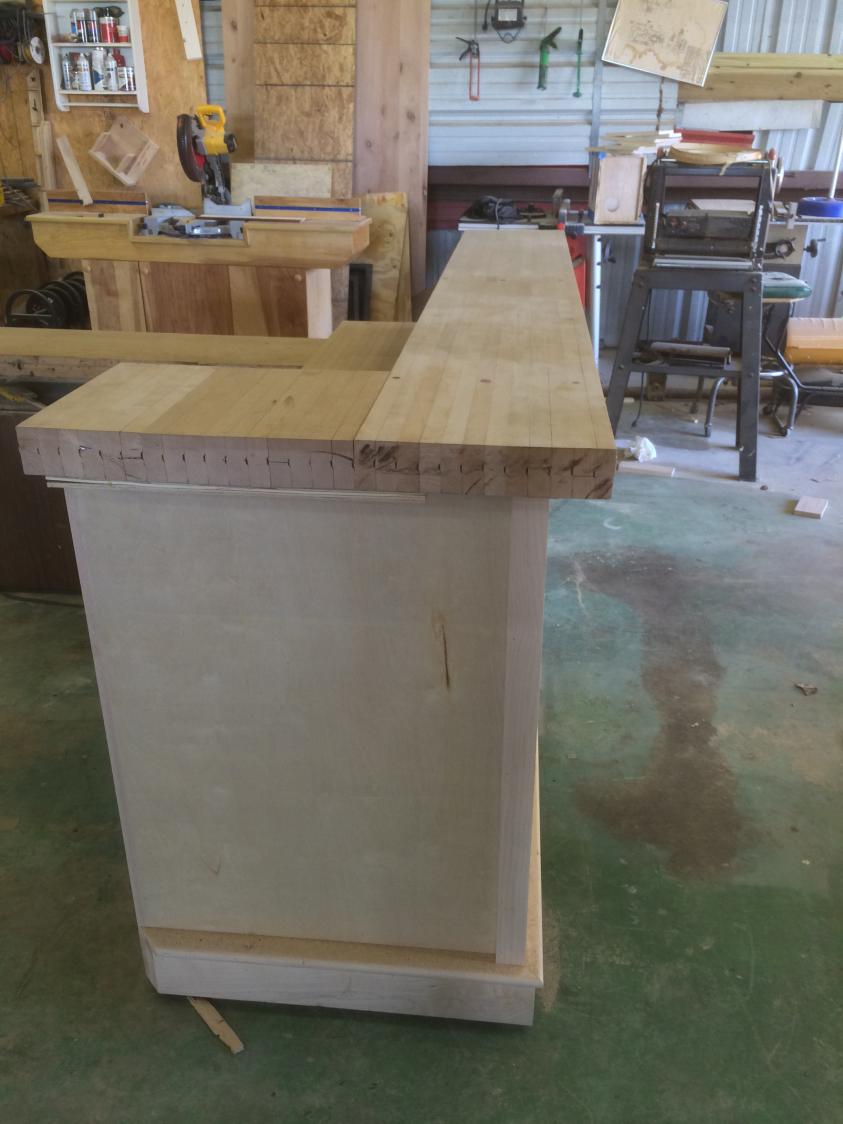

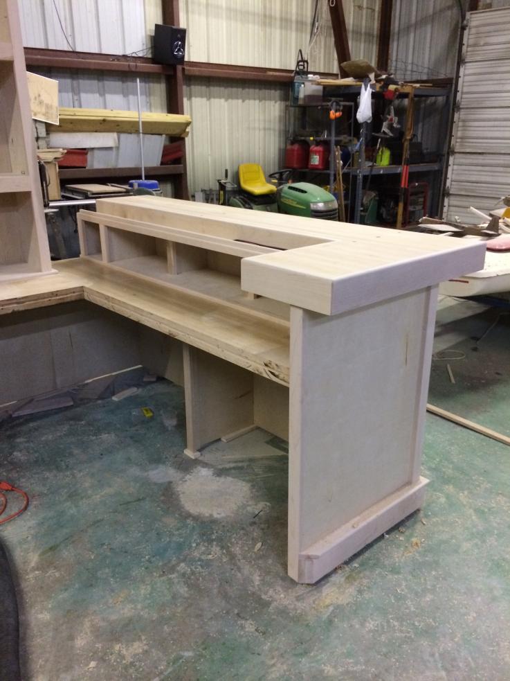

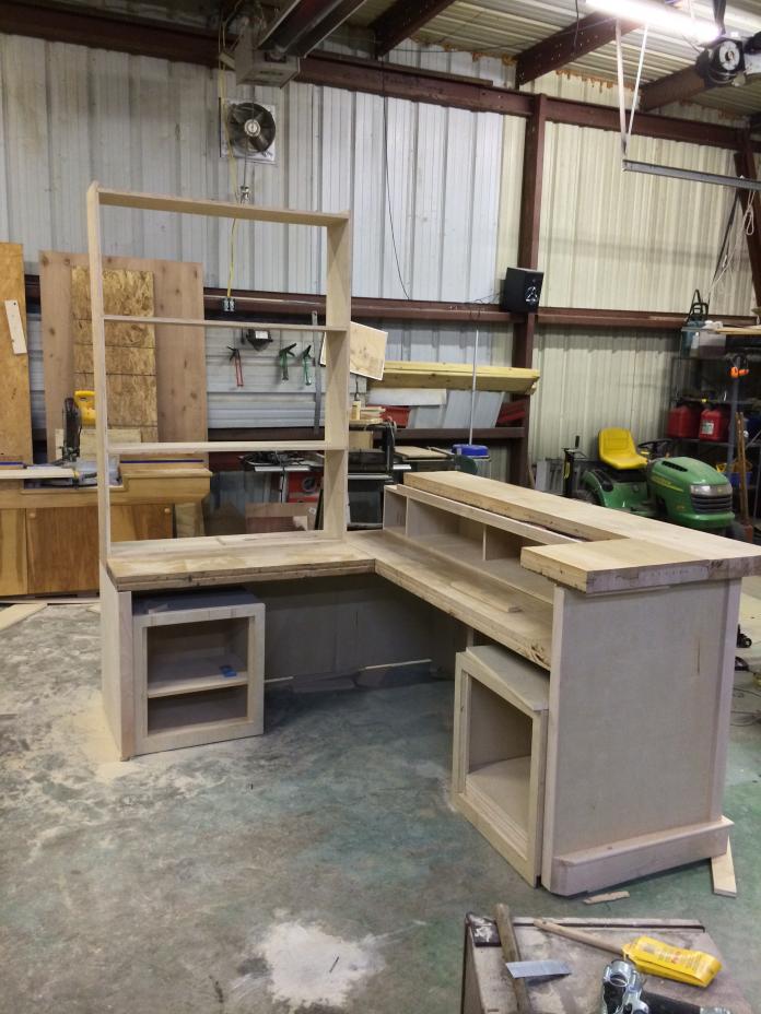

    What the hell. I was going to wait to post up progress but here are two pics from night-before-last....

    Incredible work. Seriously impressive!

    Agreed! Wish I could do that kinda work and had that kinda workshop.

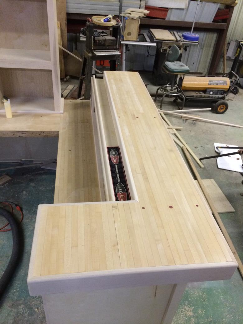

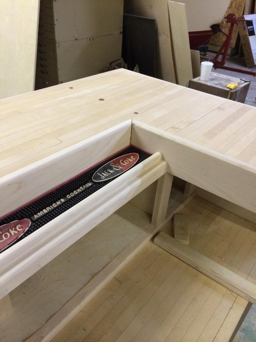

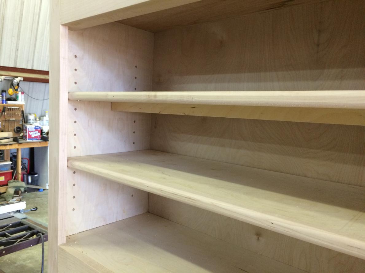

    Quick Update with Pics. Got the top bar edges installed and the shelving to the left now has a back and adjustable shelves.
    The bar mats showed up on the brown truck, and I am getting close to starting stain. I just have two pieces of trim to install on the lower work surfaces....
    I might still make doors for the lower two slots in the cabinets....
