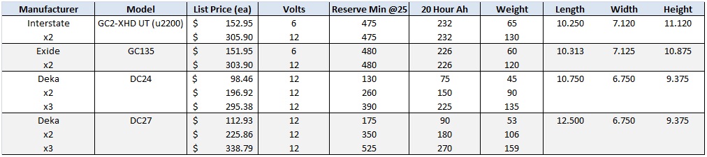

    It seems like many of us are planning to do the 6 volt swap over winter, and others have questioned it, so I figured I’d share my rationale for making the switch.
    For comparison sake, I chose to compare 2 of the easiest to obtain ‘golf cart’ 6 volt batteries (the Interstate GC2-XHD UT (formerly the u2200), and the Exide GC135) to the Deka DC24 and DC27, which are deep cycle marine Group 24 and Group 27, respectively, and available under many different private label brand names.
    Looking at the chart, you’ll find that 2 of the 6 volt batteries will be equal in capacity, weight, and cost to 3 of the Group 24, and like 2.5 of the Group 27s.
    For me, putting 4 batteries in my boat (3 house, 1 start) will be more work than I want, so the easy choice was to get the 2 best performers I could.
    Also important to note, the above chart shows MSRP - I was not able to locate a source for the Interstate batteries (which MMANDLEY is using) so I researched and located the comparable Exide, and was quoted $119 ea, further enforcing that this is the best choice for my needs.

    Ian, I went with two Group 29 125AH marine deep cycle batteries from Costco, cost about $90 each, for my stereo bank. If you are looking to get the most play time out of two batteries, I don't think you can beat this option. And it's less expensive to boot.

    It can be hard to compare specs from battery brand to brand to brand. For example, I don't believe the specs on some of the Walmart offerings. The amount of lead is a major determining factor in performance, which can't be cheated. I tend to trust the specs when the battery weight closely corresponds as a ratio to the amp/hour capacity. There seems to be a uniform relationship with all the quality brands shown in Ian's graph so it looks legit to me.
    Not included is the Deka group 31, which generally is a 15 to 20% increase in capacity over a group 27 and a nice bump over a group 29.
