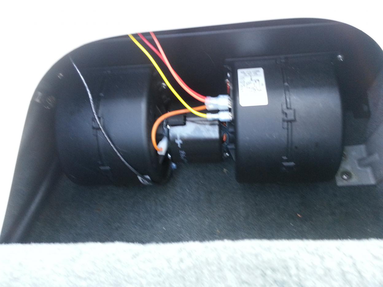

    I installed a heatercraft 3 outlet heater in my 2012 outback v.
    I purchased the package which includes 1 vent and 2 hot tubes.

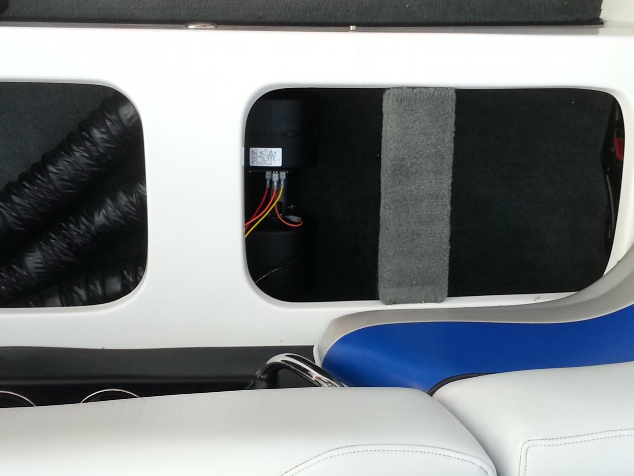

    The heater was mounted on the port side towards rear of the boat. The space is very tight here, so I was only able to drill the screws into one side; it seems secure enough.

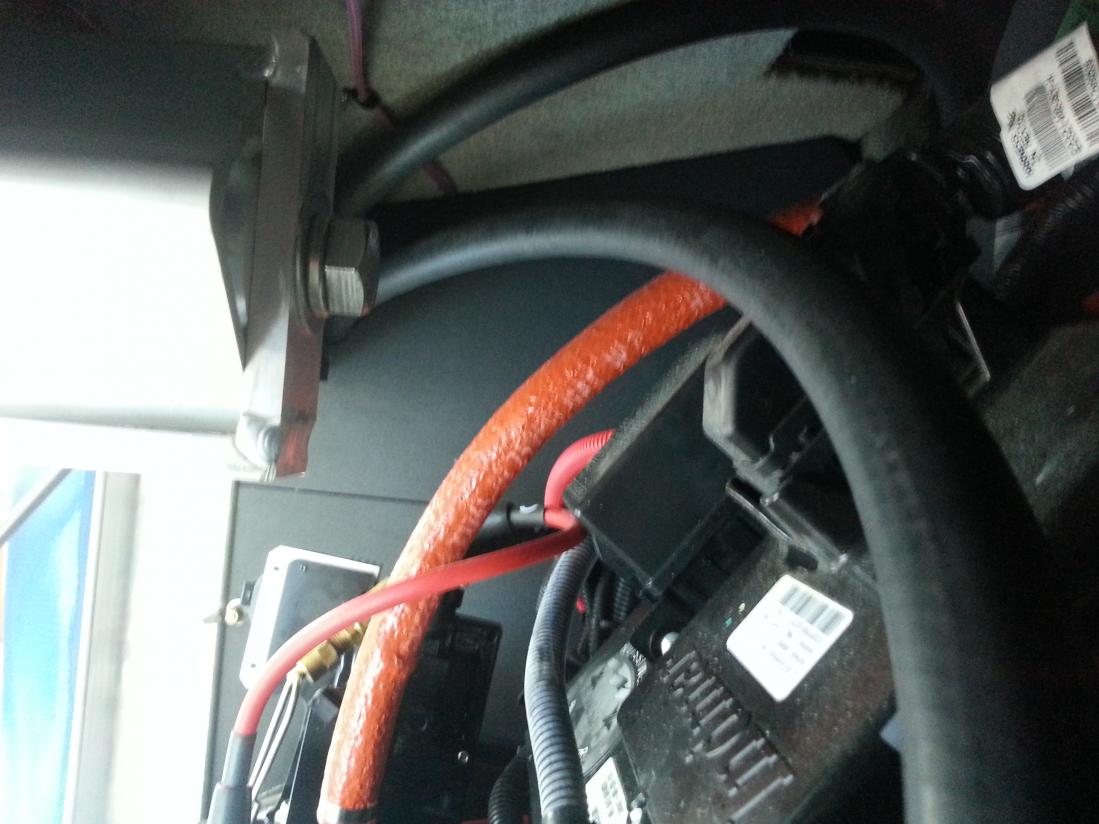

    You will also need some wire connection pieces and tape for the engine mounted hardware.
    After I extended the wire I ran it up towards the battery and followed the predefinded route used by the main power to access the drivers panel.
    The engine connections are labeled so this was very straightforward.
    I had to drill a hole into the black plastic divider panel to run the hoses through. This is the small panel and not the one that folds down to allow engine access.

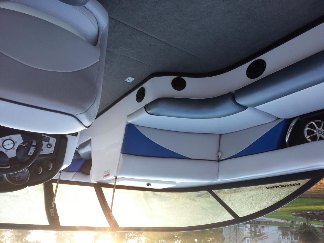

    The hot tubes easily reach the driver therefore I didn't see the need to run the vents all over the boat.

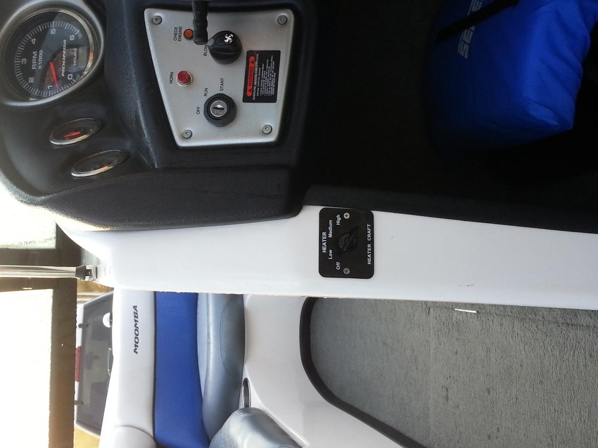

    I located the switch in a location where passangers can access it without interrupting the driver.

    I like your switch location. Good call.

    Is that under the seat? Was there no space under the driver console?

    Also, how long are the tube "holders" for the extendable hot tubes? Just wondering what kind of space will be required. I'd like to have 3 of them but not sure on mounting in compartments.
