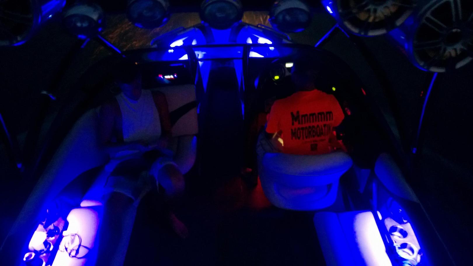

    I put led strips in my boat up under the overhang by the speakers and I put super glue on the back of the light strip so it would hold up better, I got them at k mart for $15 for two of them, I have only had them in the boat for about a month now but they still work great and light up the boat really nice! You can see them in my profile pic or avatar, whatever you call it, but I will be adding more this winter on the tower to shine down into the boat. Not sure if thats what you are looking for though, but I think if you tuck them under where they wont get beat up on, they should hold up.
    2008 Mobius LSV
    Here is a blown up picture of my strips in the lev
    2008 Mobius LSV

    Yes - the strips are great and I've also found that super glue is a must to keep them from falling down - especially if you have to go around any curves or bends. I've actually had pretty good luck with getting them on the cheap off eBay.
