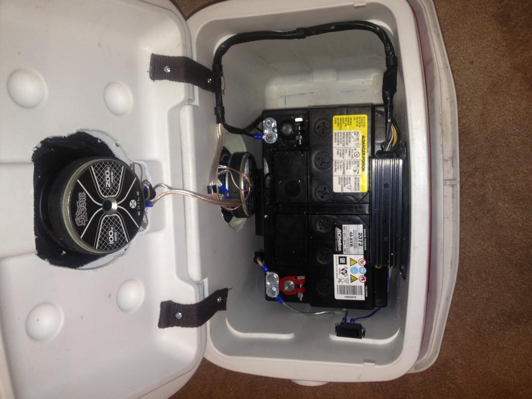

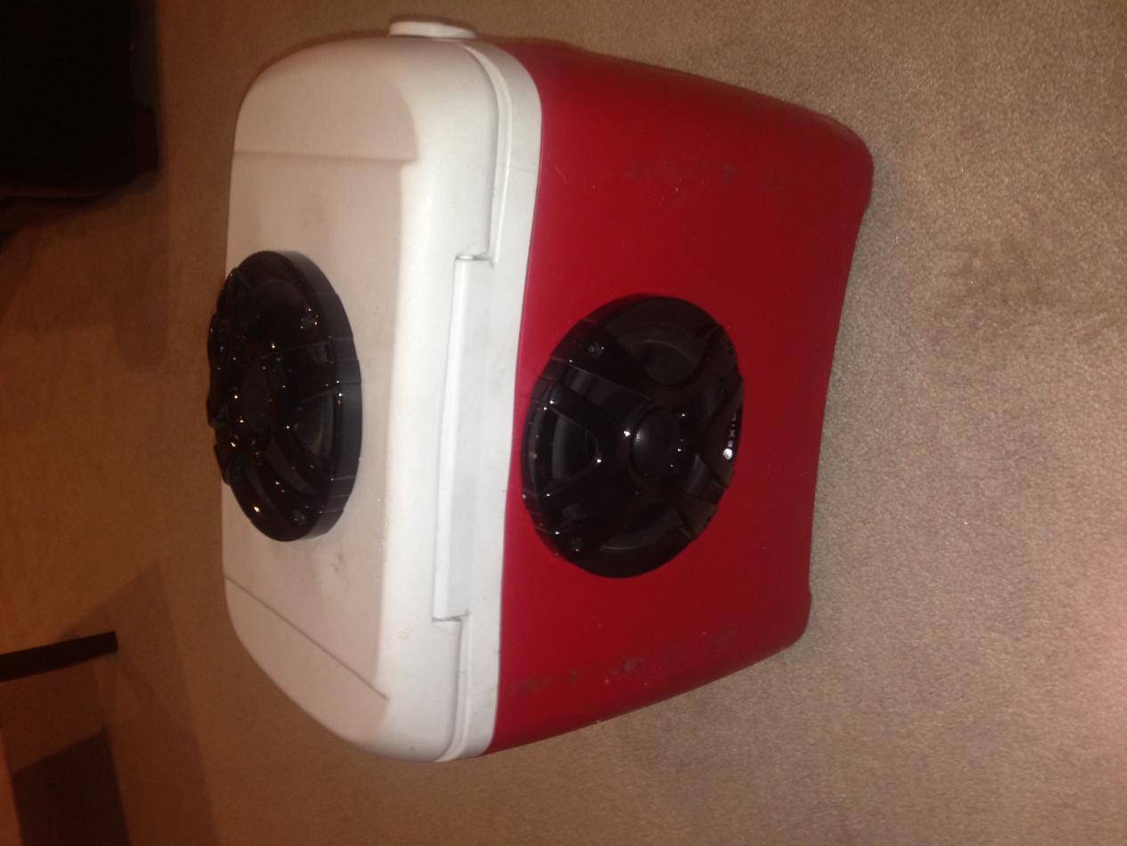

    Ive had extremely good luck with mine. I used all budget equipment and can get about the same 8-10 hours of playtime on the lawnmower battery.
    I would love to build another with Exile amps ans speakers but no way can I convince Ash that I need to spend a few hundred on it.
    Ive got a few ideas for a better version two if the equipment winds up piled up in my garage. Would def sell the first version.

    Mine is just a cheap little amp that my buddy had laying around, he wasn't sure if it even worked but was like here try this. Turns out it worked really well for how I used it.
