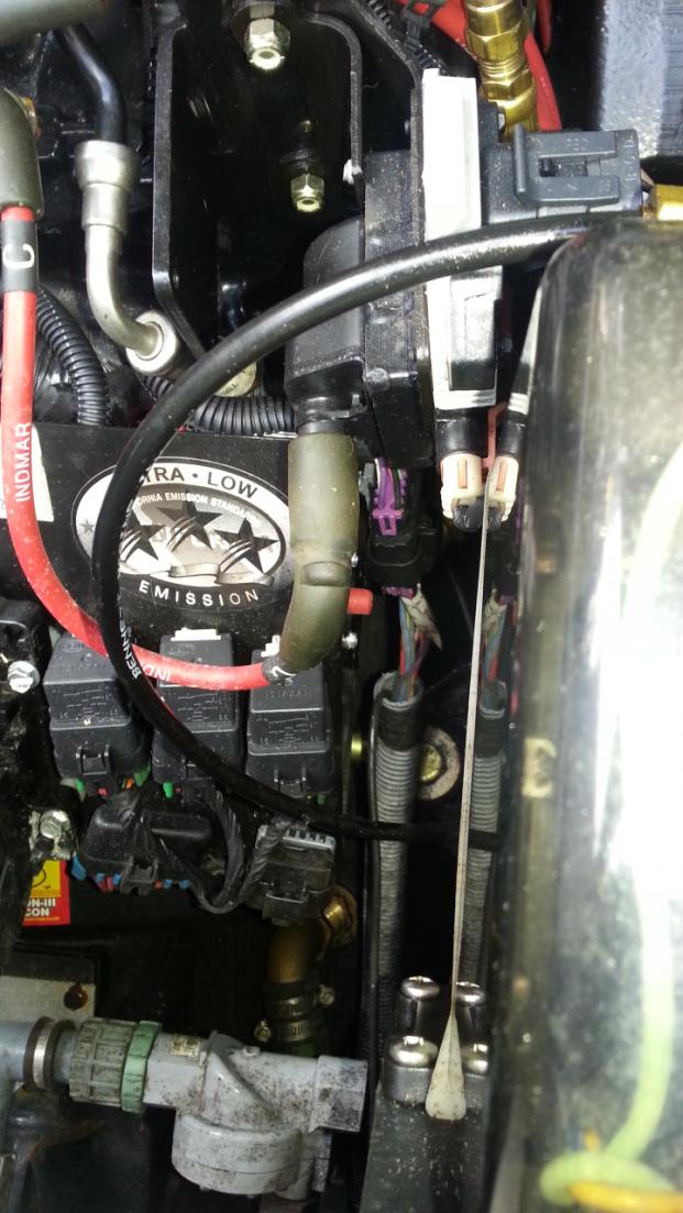

    Figured it out tonight, indirectly from this board. Saw a different thread which mentioned a breaker in the engine compartment, so went looking for it. Found it, pushed it and it clicked
    Hotwired the ignition (ignition is still broken) and the starter engaged!
    If your are interested in the location of the breaker, it is the red button (pushed from right to left) in the picture below that is to the right of the CA Emission Sticker and appearing under the coil wire
