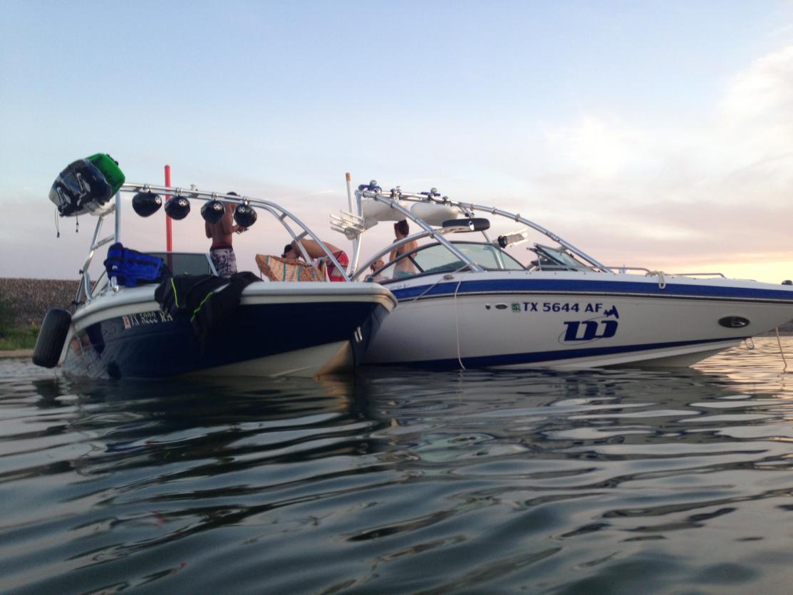

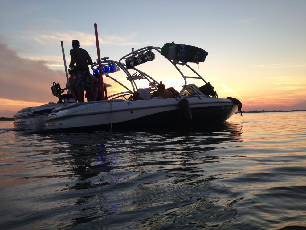

    Damn I forget to take pictures. Grabbed these tho.
