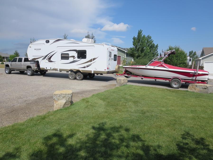

    What is your overall length from front bumper to swim platform?

    Quote Originally Posted by jstenger View Post
    72ft 4in - I've got about 3 ft to spare. That's gonna come in handy here in the near future
    how do you get the boat trailer hooked up?
    Really easy. Just back up the camper slowly and get it fairly close. With the fulton dual wheel jack you can manuever the boat quite a bit to get it hooked up. A spotter helps alot!
    Did you, or should I say, 'how much' lift went onto the 5th wheel to line up with your truck? Just an axle/spring flip? Looks like she's ridin pretty tall.
    About 7inches. They are torsion axles so it has a boxed frame that was added to to get the lift. Extra clearance comes in handy here when trying to get into the forest service. Local trailer shop did the work and replaced the bumper with new and reinforced for the tandem pull.

    What size fifth wheel did you end up getting? Is your truck a duramax? If not, which gasser do you have?
    Good thread BTW. When I was a kid my dad pulled our jetskis behind the fifth wheel. One time we had a flat and didn't know, luckily somebody on the highway flagged us down! In Michigan you need a "Double R" endorsement, and I think the length limit was recently changed from 69ft to 75ft. It was funny, a couple years ago when I went to get my endorsement the lady at the Sec of State had no idea what I was talking about when I asked to take my Double R test, she had to go look through files to even find it since she had no idea it even existed!
    I choo-chood with my duck boat behind my half ton and old small (20 foot) fifth wheel up through last year with no problems at all. I "upgraded" last fall to a 25ft 5th wheel and a 3/4 ton truck, and I've been thinking about choo-chooing with my LSV. I'm concerned with the overall weight and the overall length, but your setup gives me hope. At least in Michigan other rules are the fifth wheel has to be heavier than the rear trailer, and the truck has to be rated to tow the total weight (not sure how they'd verify that on the road). My fifth wheel is about 5300lbs dry, and my boat has got to be about 4000lbs, so especially including people, gear, and gas I'm stretching the limit on my 2000 Dodge 3/4 ton if it's even that high. Not to mention I think the old 5.9L gasser would struggle a lot with that weight, so I would likely have to trade up to a diesel rig. We would only do it once or twice a year probably since we live on a lake and rarely take our boat elsewhere, so I could maybe get away with it.
    Question for jimmobius if you read this...how in the world did you get away with pulling a jetski behind your boat behind a class a? I thought it was only legal to double up behind a fifth wheel, had no idea it was legal with a bumper pull. I know at least in Michigan it's not legal, maybe other states it is?
