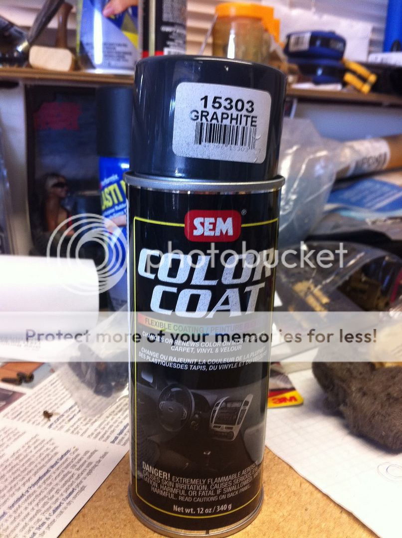

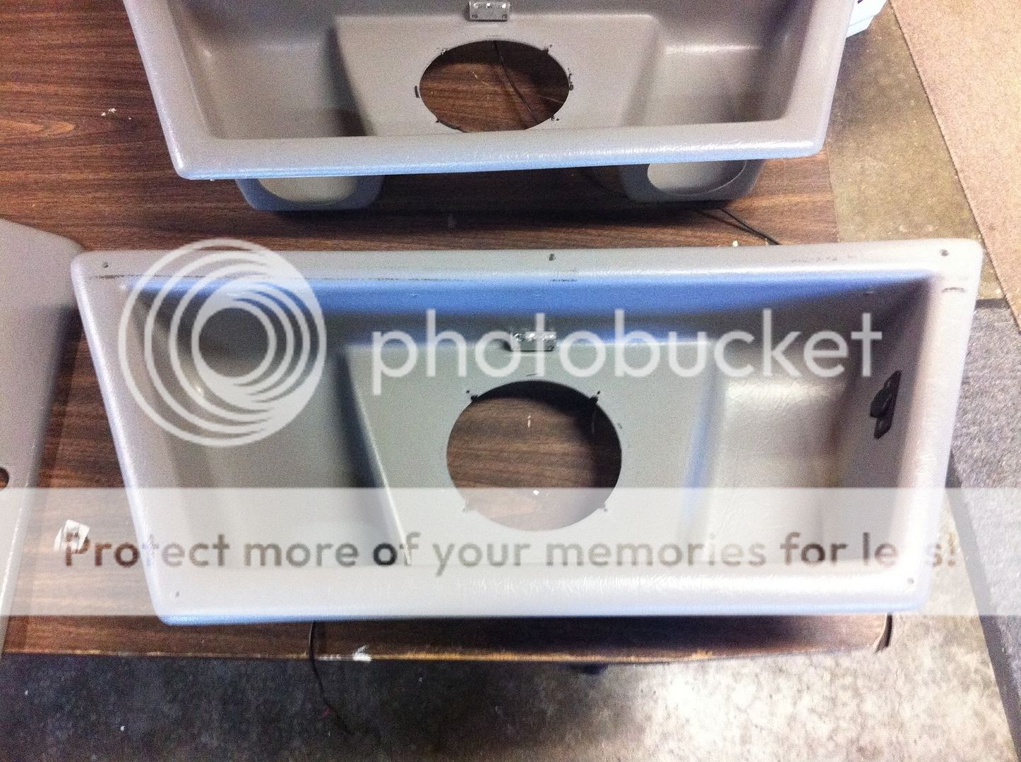

    The change up on the other colors from light gray to graphite - speaker plastics, glovebox, dash, grab handles, steering wheel, etc all came from me. I was a little iffy at first but am extremely happy with the outcome.
    I used this on the plastics - wipe down and clean with laquer thinner, then several light coats. Amazing stuff!

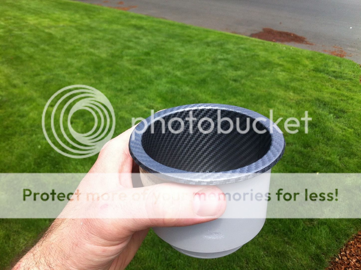

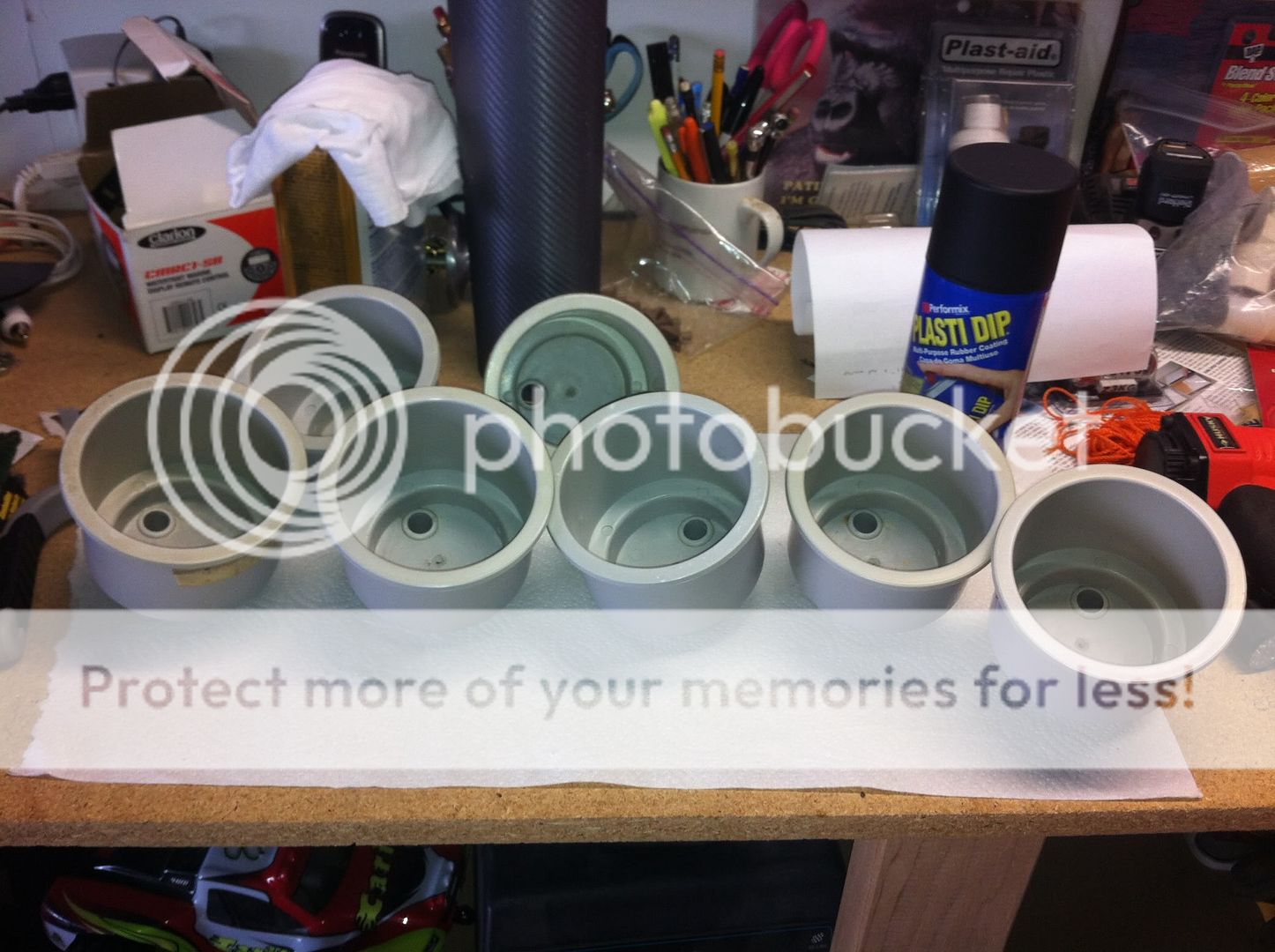

    Carbon fiber wrap on the cupholders, steering wheel center, rearview mirror is 3M brand off amazon. Also cool stuff.
  4. #34
    4,977
    Black plastidip the bottoms, cut, wrap and heated the carbon fiber to stretch over the lip. I kinda wanted to go stainless but I don't have stainless anywhere else. So the darker tone goes well with the graphite color everywhere and I haven't seen any others out there. Plus I haven't done much original for pimp points lately...

    I knew you were holding out on us. It looks fantastic. I agree with the carbon fiber in your boat with no stainless anywhere. And I love the color change from the washed out look to the modern graphite look. It really makes it a new boat. So nice.

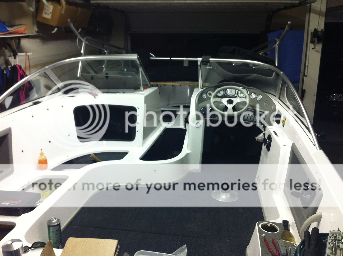

    Ok, here's proof he actually worked while I drank all his, I mean OUR beer.
    My son being so helpful supervising
    These nasty old amp racks did go away. The Ex's sure are nice!
    Then there's that new carpet smell!
