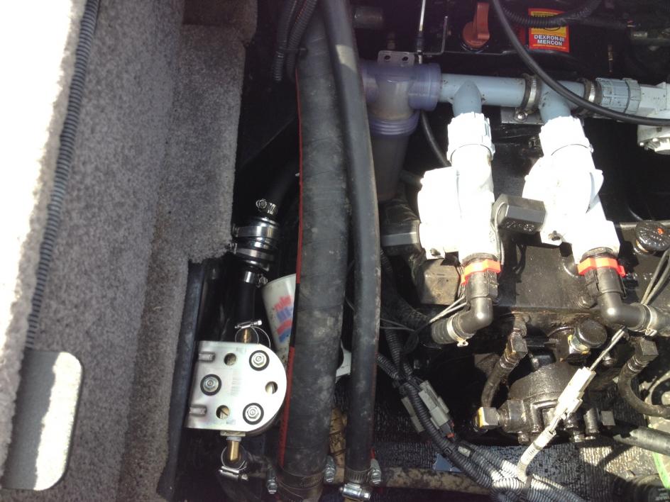

    Here's a pic of the boost pump installed.

    Nice to see an actual pic of the boost pump. I've heard of others installing it with good results. If my ritual didn't fix my issue I was going to look into the boot pump. Hope this is the fix for you because I know how frustrating this problem can be.
