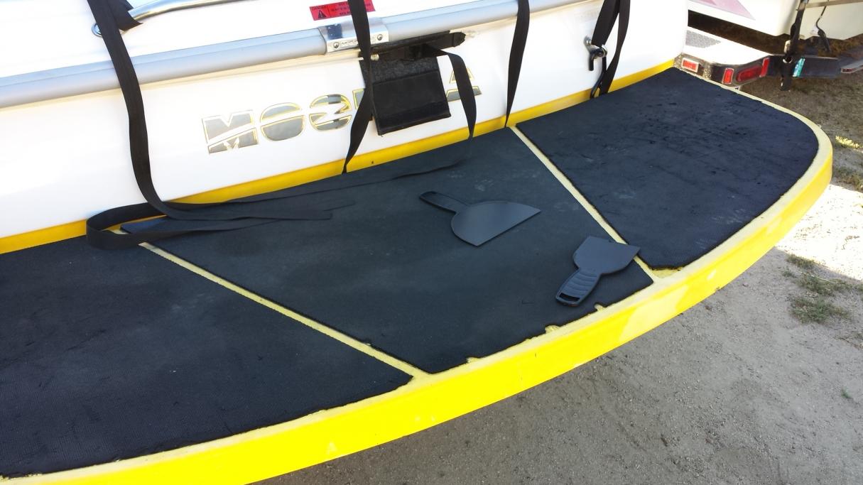

    The black on our swim platform comes off and leaves marks all over. Has anyone else experienced this and have you found a solution?

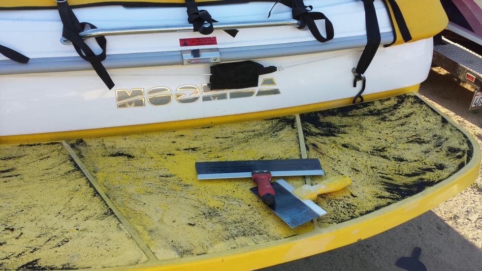

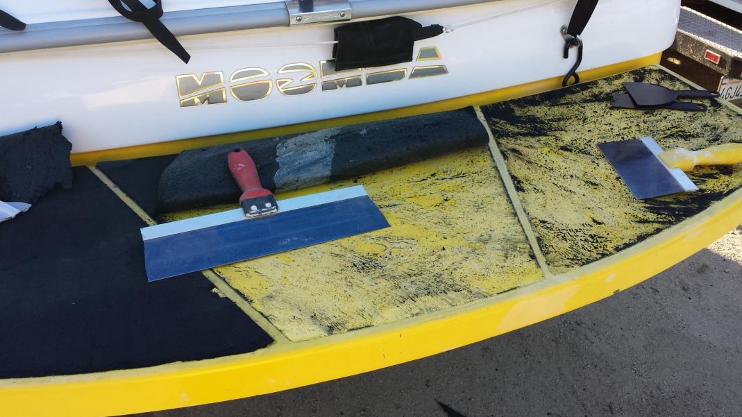

    1. Putty knife
    2. Mineral Spirits
    3. Acetone
    4. Gasoline as a last resort (Of course NOT...well...)
    5. All in a ventilated area (i.e. outside)

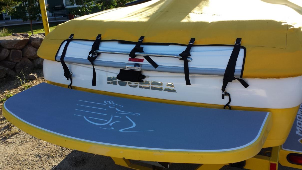

    6. Call SeaDek
    Eric.
    13,051
    Got that out of order. 1. Call Seadek. Wait about 5 weeks. But it takes 4 weeks to scrape that crap off anyway.
    You aint kidding about waiting twelve years to let that old glue harden! I waited until we had the two hottest days of the year so far (105 in NorCal) and wasn't sure if the stinging was the sweat in my eyes or the gas fumes (Which I did NOT use and do NOT recommend!)
    But I get more compliments on that stupid pad!!
