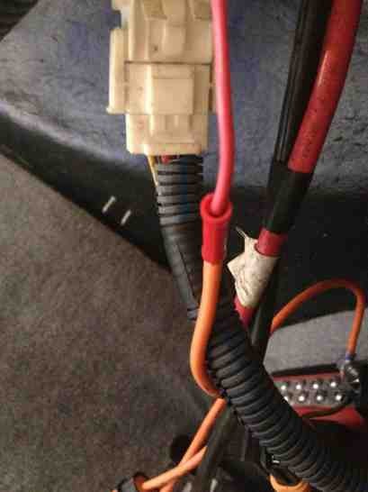

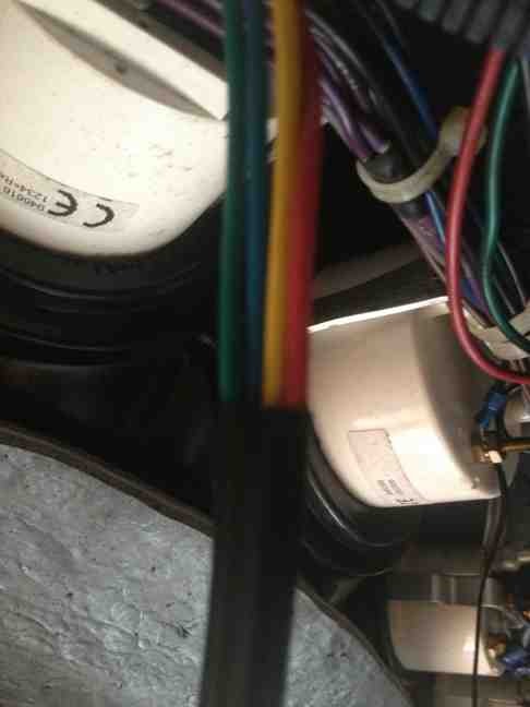

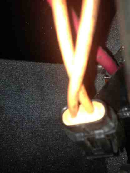

    4 wires coming out of trim red goes to 25 amp fuse and then to buss bar. The other 3 to back of boat hydraulics Where do I run capacitor

    Here is a link to a previous post made by Phil where he has provided instructions and a diagram. The easiest place to wire those in will be under the helm where the wires leave the switch.

    Awesome just got it done. 95% of pop is gone. Wonder if a larger cap would do better. I am pleased with result but still a little crackle now
