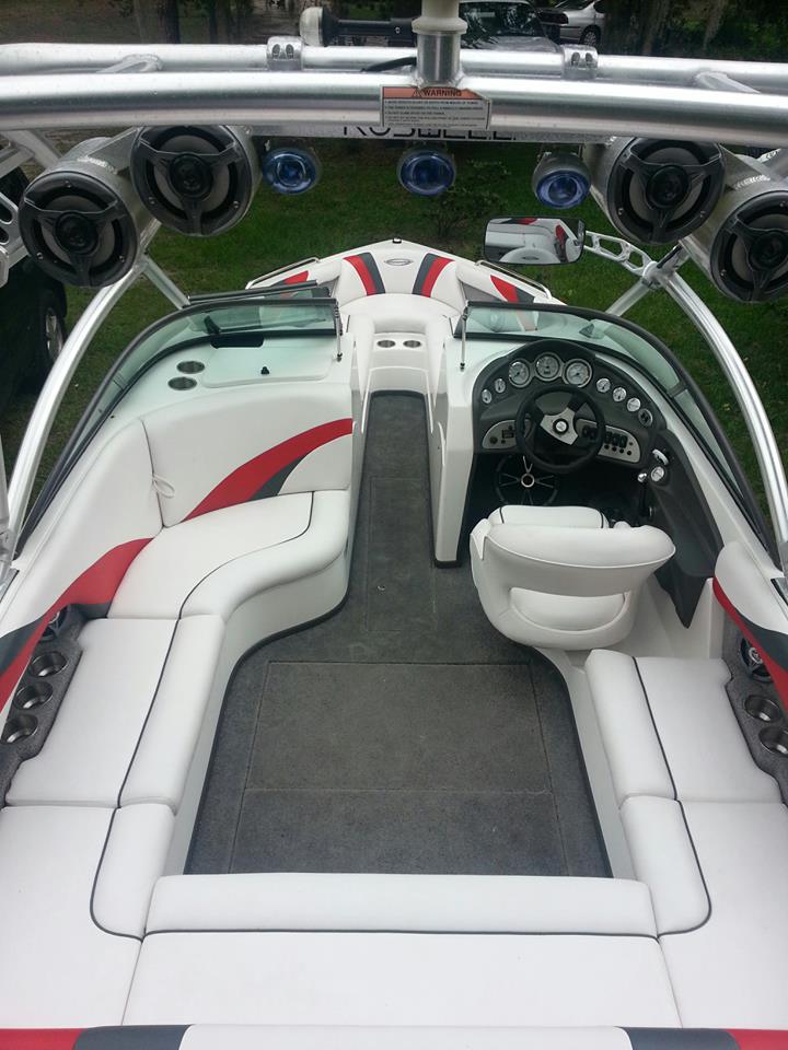

    Just bought a 2007 moomba mobius LSV with 20 hours on it. Love the boat but I need better audio.
    Trying to figure out how this thing is wired and I think I have it figured out.
    Boat has a roswell speaker cluster on the tower and Kenwood KFC-1608ie all around. Thats 4 in the cabin, 2 in front, and 4 on the tower.
    There is a kenwood KDC-Mp232 head unit and a KAC-x542 4 channel amp. The amp appears to be driving the front speakers on channel a1 + a2 and the tower on b1 + b2. The cabin seems to be running on the head unit.
    There is also what appears to be a 12" sub. Cannot figure out how it is powered (perhaps its own amp module in the sub?)

    Here is a pic of her all cleaned up
