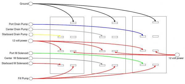

    Hopefully this helps
    I am not understanding what I should do?
