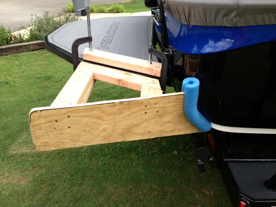

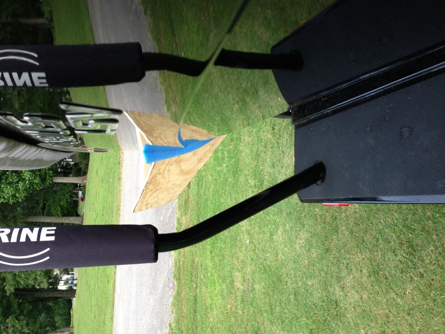

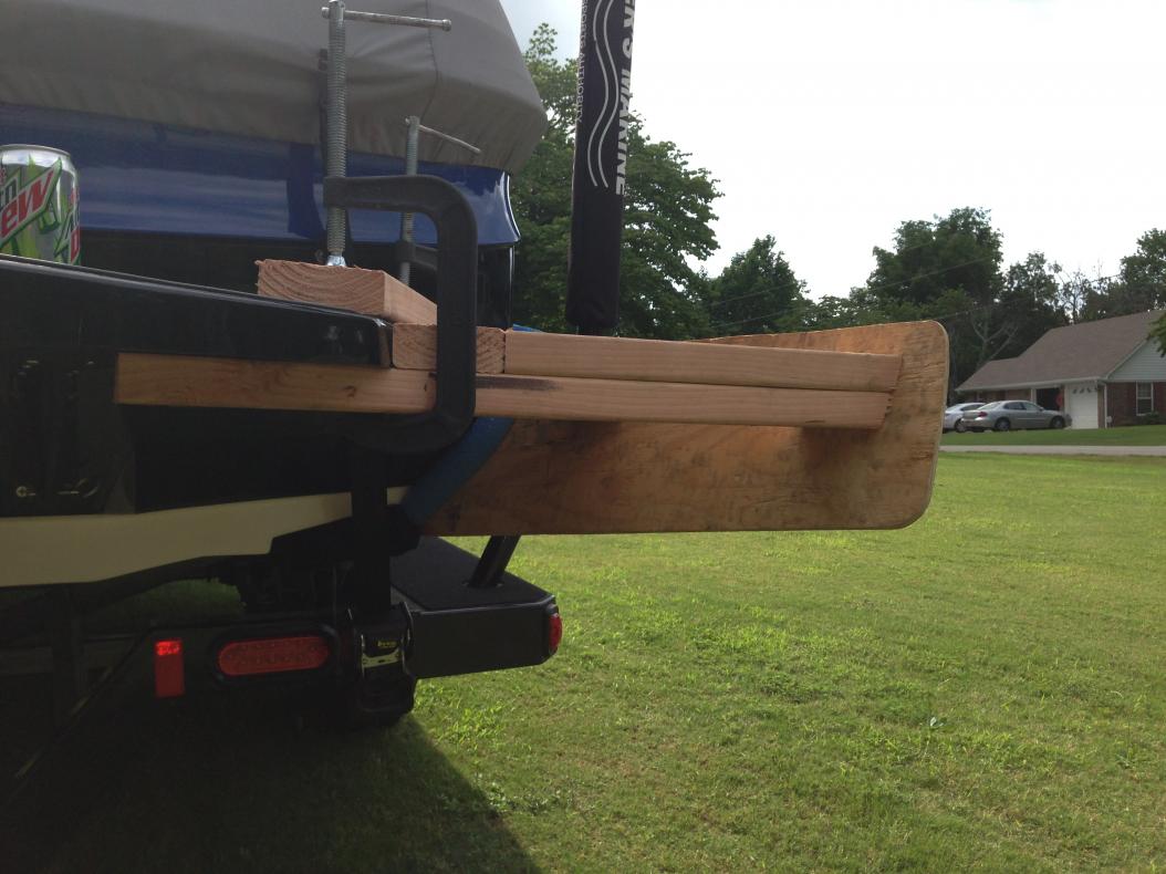

    After seeing all of the DIY Surf Gate attempts on other boats I figured there have to be folks trying this project on their Moombas.
    The weather was crappy here this weekend so I figured I would have a go at it.
    No, this is not a finished product by any means. It is a throw away test model that I will try in the next week or so.
    I went with a 22.5 degree angle from the hull, and a 15 degree angle from top to bottom. I will let you all know how it works.
    With the way I have it mounted (the redneck way) it doesn't touch anywhere on the boat, and is sturdy enough to shake the boat trailer when I push/pull on it.
