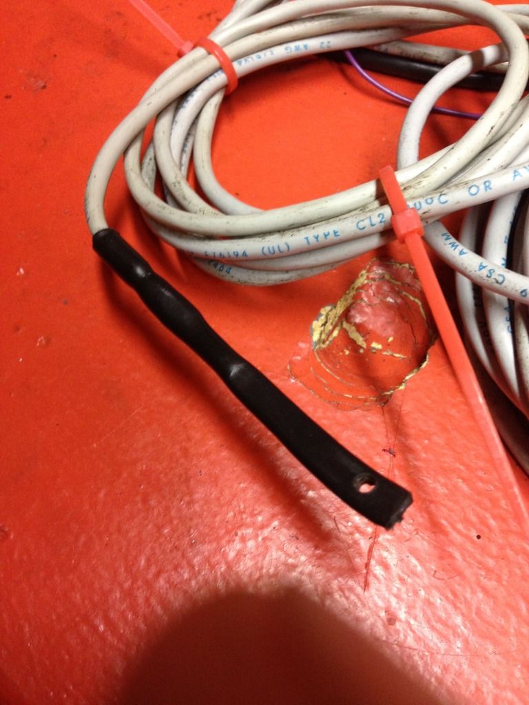

    So I picked up an older, unused depth gauge/ water/air temp gauge from a guy on the Moomba board over the winter. I'm going to install it soon but I was just looking at it the other day and I can't tell which sensor is the air and which is the water. It didn't come with instructions or anything. One sensor is cylindrical and made of steel, the other is a flat piece of plastic. Both are about 2.5 inches long. Which is the water sensor? Also, anyone installed one and have advice as to how/where to install the water sensor?

    Here are those pics, first the flat black plastic piece:
    Here's the steel cylinder piece:
    The wire for the steel cylinder is SIGNIFICANTLY longer than the one for the plastic piece, like 3x as long.

    To tell which is which apply 12 volts to it and stick one in water leave the other in the air. The air temp will read both in water and out but the water temp should read a false reading if left in the air.

    Thanks for the advice. I've tried searching online but the product line has been out of commission for years. My guess is the sensor that has the longer wire would be the water sensor, for getting it down to the water. Especially considering applications like cabin cruisers and whatnot where there would be a lot more distance to travel. If that's the case, how would you guys suggest installing that steel cylinder sensor?

    Makes since. Depending on its diameter, try to get a u clamp to fit over it and screw it into the very bottom most place on the transom unless you can attach it to something that low. I would even go as fare as trying to mount it to the bottom of my wake plate just so i don't add holes to the boat.
