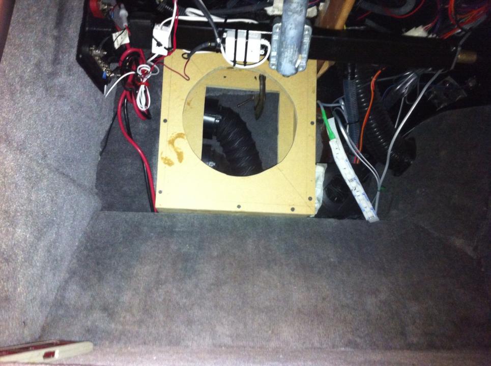

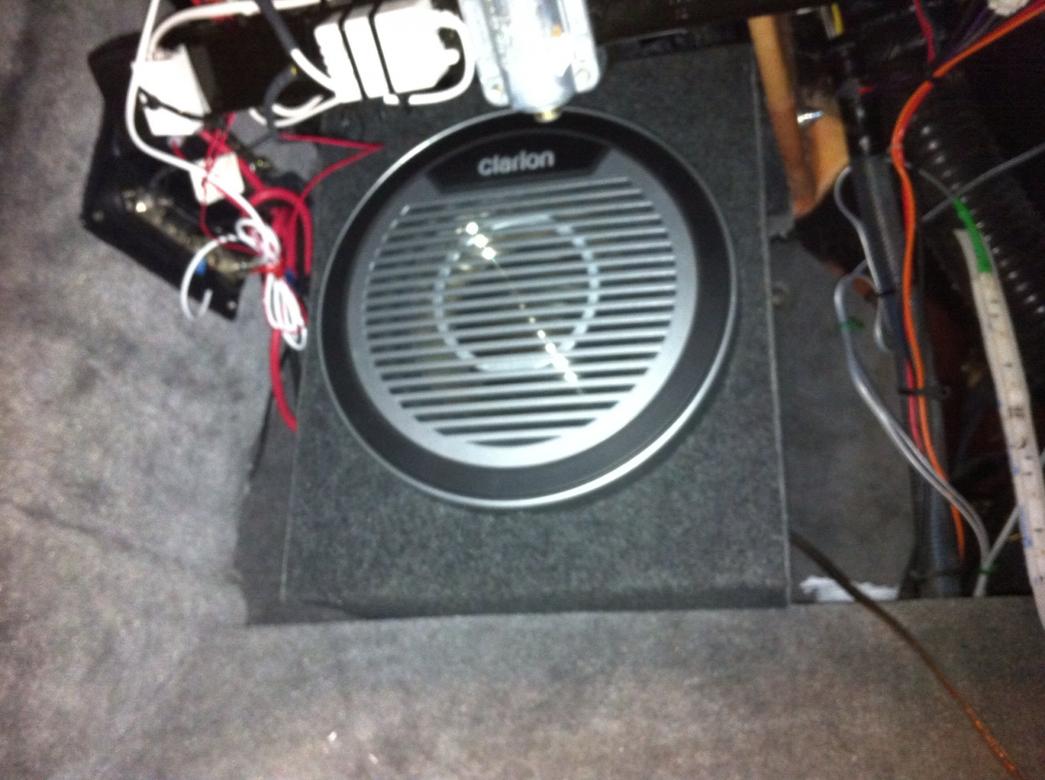

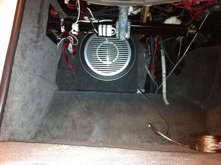

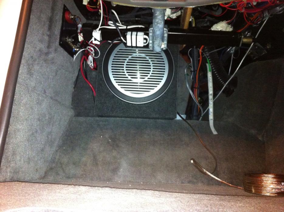

    I just install my amp also on my outback 2006.....I didn't know there was a pass way. I passed my wires from one side to another under the seat in the bow!! I also build a small box for the sub.... I'm 6'3" and it not in the way at all
    Dec 2012
    Trois-Rivieres, Quebec
    183
