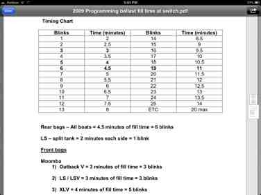

    Very complicated IMO. So much so ive yet to do it
    2009 Ballast System Programming
    To change the fill time of the ballast:
    1. Connectbatterytothewiringwiththe60ampbreaker.
    2. Disconnectpowertotheballastcontrolboxbytrippingthe 60ampbreaker located by the battery.
    a. This will have to be done for programming each ballast control box. (Left rear ballast, Right rear ballast, and Front ballast)
    3. Resetthebreaker
    4. Within5secondsofresettingthebreaker;toggletheballa stswitch(ofthefilltime you want to change) FILL-OFF-DRAIN-OFF- FILL-OFF
    a. StopwiththeswitchtoggledtoFILL.
    b. Thiswillenterballastcontrolboxintoprogrammingmode.
    c. When the ballast control box goes into programming mode the
    pump will quit turning on.
    5. TheLEDontheballastswitchwillblinktoshowcurrentfill time.
    a. Whencountingblinkswaitforthesecondblinkcycleaftert he
    pause, blinking starts as soon as reprogramming has started and it
    is easy to miss the first few blinks.
    b. Refertothetimingcharttodeterminethecurrentfilltime basedon
    the number of blinks.
    6. ToADDTIMEtothefilltime
    a. To add 30 secs, turn ballast switch to FILL then OFF.
    b. NumberofblinkswillincreasebyoneeachtimetheFILL-OFFis
    toggled.
    c. Add remaining number of toggles of FILL - OFF to get the desired
    number of blinks from the timing chart.
    d. End with the switch toggled to FILL to count the blinks.
    7. ToREMOVETIMEfromthefilltime.
    a. Toremove30secs,turntoOFFthenDRAIN
    b. NumberofblinksdecreasesbyoneeachtimetheDRAIN-OFFis
    toggled.
    c. Add the remaining number of toggles of DRAIN - OFF to get the
    desired number of blinks from the timing chart.
    8. Whencountingblinkswaitforsecondblinkcycleafterthep ause,blinking starts as soon as reprogramming has started and it is easy to miss the first few.
    9. Whencorrectblinksareobtained,switchtoOFFandwait10s econdsto allow program to be set. This will now be stored in the AI unit.

    TIMING CHART
    Blinks
    Time (minutes)
    Blinks
    Time (minutes)
    1
    2
    14
    8.5
    2
    2.5
    15
    9
    3
    3
    16
    9.5
    4
    3.5
    17
    10
    5
    4
    18
    10.5
    6
    4.5
    19
    11
    7
    5
    20
    11.5
    8
    5.5
    21
    12
    9
    6
    22
    12.5
    10
    6.5
    23
    13
    11
    7
    24
    13.5
    12
    7.5
    25
    14
    13
    8
    ETC
    20 max
    Rear bags All boats = 4.5 minutes of fill time = 6 blinks LS split tank = 2 minutes each side = 1 blink
    Front bags
    Moomba
    1) Outback V = 3 minutes of fill time = 3 blinks 2) LS / LSV = 3 minutes of fill time = 3 blinks 3) XLV = 4 minutes of fill time = 5 blinks
    Supra
    1) 20 SSV = 3 minutes of fill time = 3 blinks
    2) 21V=4minutesoffilltime=5blinks
    3) 22 SSV Walk-Thru = 3 minutes of fill time = 3 blinks 4) 22 SSV Play-pen = 4 minutes of fill time = 5 blinks 5) 24 SSV Walk-Thru = 3 minutes of fill time = 3 blinks 6) 24 SSV Play-pen = 11 minutes of fill time = 19 blinks

  9. #19
    Belton, Texas
    2,595
    Default 2009 mobius lsv adding fat sac 750
    2009 Moomba Mobius LSV
