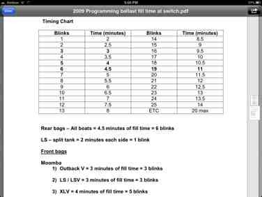

    Going back to his original question, does he have the reversible pumps in a 2009? I can't remember what year they went to reversible. If so, he will have to reprogram after he changes bag size. Not sure why he would need the Tsunami pump in that case. On the other hand, if he's got the Rule pump system he could swap the Tsunami for one of the Rule pumps used to empty or cut a new intake and pipe it in to fill one of the 750's.

    2009 is reversible., at least I think mine are😎🏄
