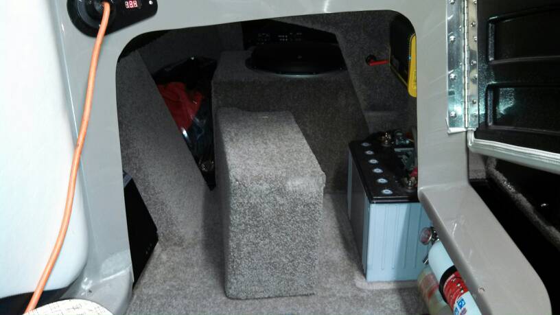

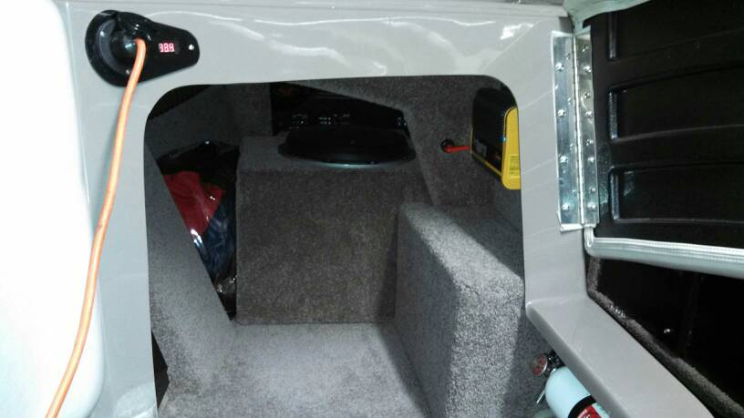

    No, that is just the back side of the bow seatback - it was like that from the factory. You might consider putting your 3rd battery under the bow seat and then sliding your other two batteries forward like I did mine. See pic below.
    Al
