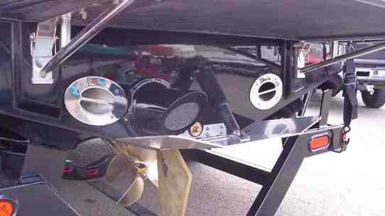

    What i think your thinking of would be something like Tige all new rear hull extension. See below
    This would be the only real way i think to extend the hull.

    iirc all that hull extension did was clean up the spray on the wake, give the wake a more solid shape and enable to wake to form/stay when turning the boat.
    he also has a lot of data on repositioning the wakeplate mounting location. it made the wake much more adjustable utilizing the whole range of movement on it. the wake could go from short for skimriders to tall for surfriders. it was only 1.5" or so, but made a huge difference. I've noticed on my plate that only around 25% of the adjustment "range" actually affects the wake. by moving the mounting point, it makes 100% of the wakeplate range adjust the wake. I don't know if this would be hull-specific in that flatter v boats might not benefit as much as deep v boats.
