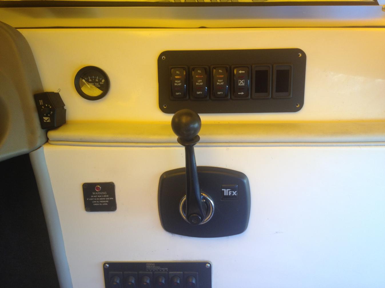

    Not much to look at yet;
    Before the switches were in a horrible location, never did get used to them, never could remember which was what and what was on or off as I couldn't see them.
    This is where the new ballast switches are including a new switch for the third X-Over reversible pump between the back two bags. Got two more future switch spaces, probably going to add some docking lights on one of them.
    Eric.
  10. #20
    Aug 2011
    1,847
    Default Re: Reversible Pumps and check valves?
    Where did you get the plate and switches from?
