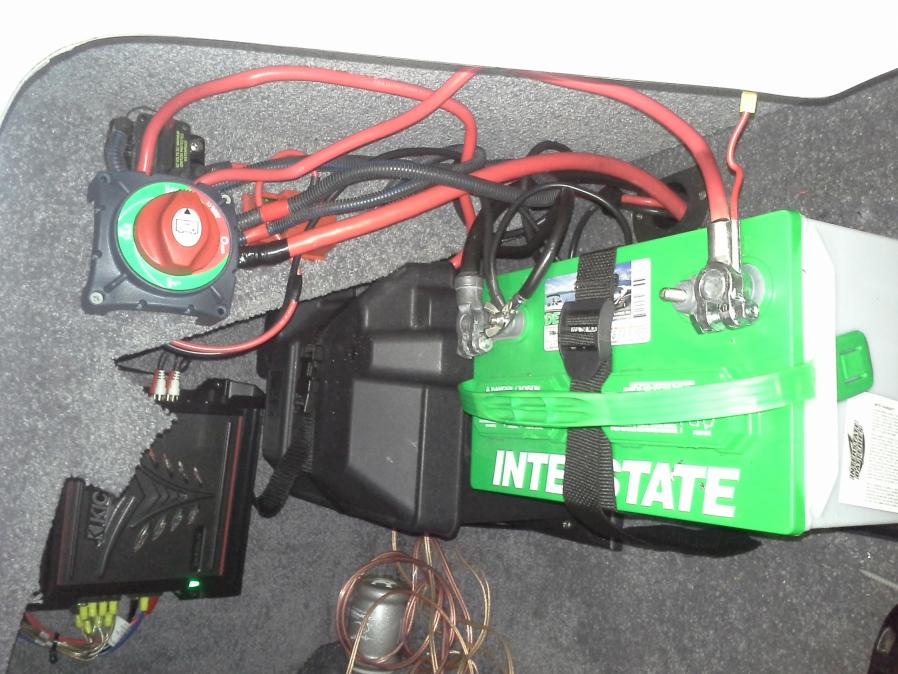

    Well. probably not the most popular choice, but I went with the K.I.S.S. option (Keep it simple stupid). I think it is gonna work out well. I would like a cleaner look if anyone has any suggestions. These cables do not like to behave.
    '08 Mobius LS

  8. #38
    Belton, Texas
    2,607
    try this again... LOL
    great job!! but stand by for all the jokes about wires and mouses. I got kicked hard for my second battery install and the sad thing is I paid a shop to do mine. I like your set up but the stereo guru's will chime in soon enuff about all them wires!

    I can change it at will. I wan't sure if I should harness them all together or not. I really don't like the sloppy look.

    You need some terminal protection, someone is going to throw something metal in there and cause a short/fire.
    Not sure but by law I think the battery needs to be in a box to contain the acid if broken?...Not sure about that one...
    Correction terminal protection is required..
