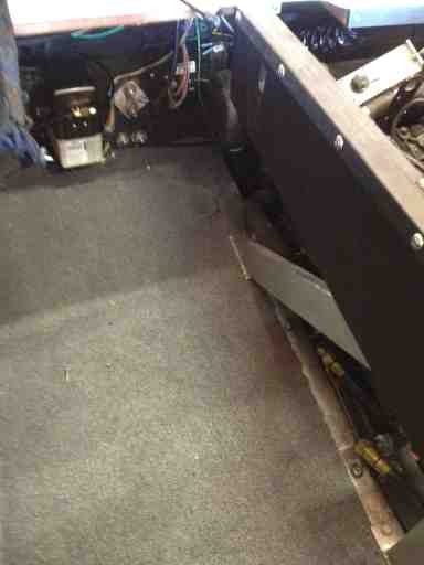

    My pylon looks like this:
    So I didn't need to reinforce the wall. I think Mandley did a write up on reinforcing his.
    I surf the port side so I left the hydraulics where they were. In hindsight I felt like I could have easily moved it to the engine compartment, I'm getting plenty of weight on that side so I'm leaving it.
    Here's what I did:
    Very simple, one screw holds it to a stop I mounted on the side panel. It's carpeted marine plywood.
    -Jake

    I put one on the other side too, obviously closer to the stern
    Blurry but you get the idea

    Here's what I did:ImageUploadedByTapatalk1353280933.829343.jpgVery simple, one screw holds it to a stop I mounted on the side panel. It's carpeted marine plywood.

    The rectangular aluminum tube coming down at 45* supports my pylon, it looks like some boats don't have that setup and have added metal in that area to support the dividing wall. My boat didn't come with any dividers (used ) so I did make those out of marine plywood too.
    I replaced that hydraulic unit since the one that came in the boat didn't work. It would have been really simple to just move it, I just didn't think to. The bag still works fine in there up against my plywood.

    As for the bracing, you will only need to do it if the bags start to Flex your engine side panel. Mine had no bracing, and just a huge open access when you lowered the side panel so thats why i did the bracing. I know on the older boats the V drive isnt quite as deep and the bracing of the engine area changed over the years.
    As for the hydraulic pump, as long os you have something covering it it will be fine. I just wouldnt let the bag rest on it.
    You will be surprised how much pressure the 750-1100 bags can put on things. I have seen countless items bent or proken in friends boats where it got left in with the bag while filling.
