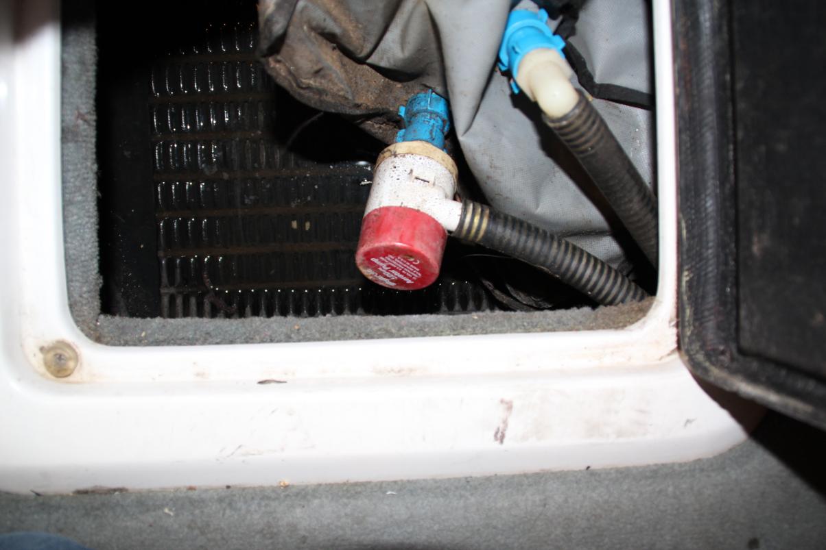

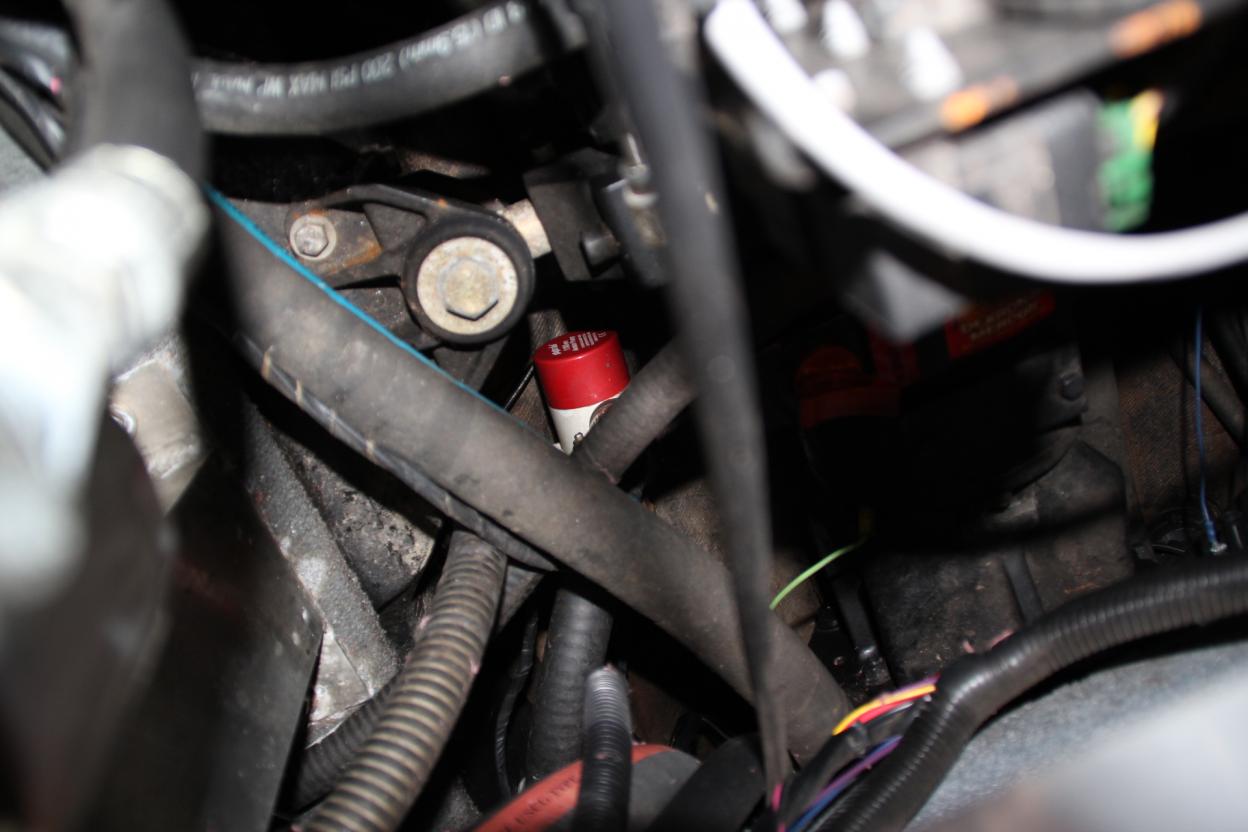

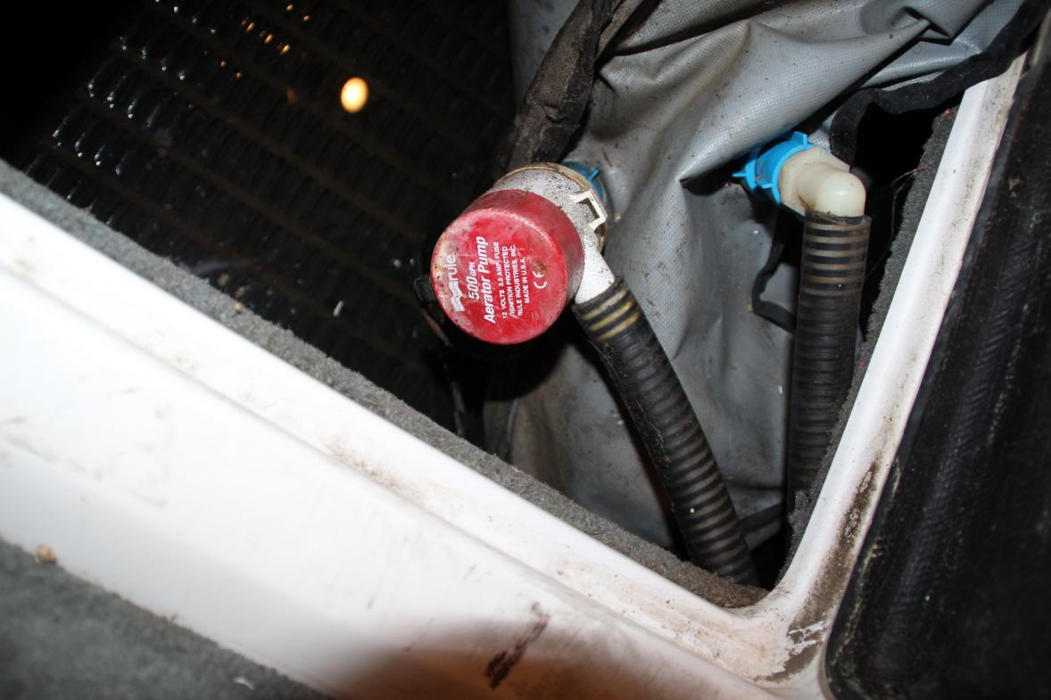

    Well it seems that what I thought was on ’01 is an ’02 I’m told and I don't know how I messed that up (Don’t get old kids!) and Berge, I owe you $10 as I was able to locate two of my pumps!
    One pump is connected right to the front bag in the locker and there is another down in the engine well, it looks like it pulls water from an under boat pick up.
    Switching over your wiring to new switches should be piece of cake (still). Which means running all new wiring to the pumps is really not necessary if they are all working at the moment. Unless you're looking for ways to tear the skin off your knuckles during the winter months.
    Well, I’m not really looking to add to my list of “to do’s” but I do have some more questions now;
    1. Where are my other pumps?
    2. How do you get to them? Is there some secret hatch under the carpet? Do I need a midget? Should I train a squirrel? (Like that is ever a bad idea)
    3. Am I supposed to have six total (plus a bilge pump)?
    4. Three fills and three dumps?
    5. It looks like I have 500 gph pumps, is it worth changing out to the 1100s?
    And while I am asking questions;
    1. I found water under my front ballast bag and the boat is inside during our brutal NorCal winter (had to put jeans on today!! UGH!) – What is the best way to get it out?
    2. What is a “Gravity” I or a “Gravity III”?
    3. What is an IBS? (I don’t think you guys are talking about dairy products….)
    Thanks again, Eric

    Best way to get water out of the under a ballast bag is just remove the bag dry it out. If your refering to the ski locker bag it is holding water due to the bilge area being connected and water sloshes while you tow the boat.
    Gavity I or Gravity III is Moomba's way of denoting how many ballast bags came in your system. If you have a Gravity I then it came with 1 bag factory and pumps. Gravity III would mean 3 bag system from the factory.
    IBS= Integrated Bow Sac. When you get the V sac for under your bow seats and plumb it in with pumps for filling and draining.
    YES in my thoughts replace the 500 with new 700 Tsunami's or 1100 if you can, this only increases fill and lowers wait time on filling and draining.

    A-dang good question, follow the hoses like you did and you should find them
    b-secret hatch-yes at least my 03 did if its a LSV, but it was the whole floor-nothing under there but wires, hoses and a gas tank. mine had 3-4 screws going into the floor sideways from under the side seat bases in the rear, cant remember were else it was screwed down as its been close to 8 yrs since I had that floor up. can be hard to findthem but once removed the floor lifts easily, heavy but easy. really no room under there for pumps tho.
    c-thinking so, mostly based off the 6 individual switch's
    d-yes, 3 fills/3 dumps-early model year boat would have a very simple system
    e-oh heck yes. personally with the arater styles I go the 1200 tsunamis and 1" hose all the way around and keep the hose lengths as short as possible. best bang for the buck I think without going to reversible pumps
    1-remove all bags, vacum out all water
    2-gravity 1--single front bag, gravity 3--3 bag system
    3-IBS= Integrated Bow Sac. V sac for under your bow seats
    observation-no hose clamps on the hoses connecting to the bag ?
    hope that helps
