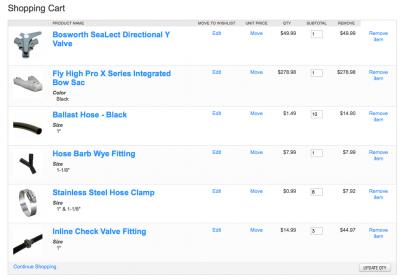

    So I've got the shopping cart ready and waiting. Can you guys tell me if there is anything else I need for the IBS install in a '13 LSV? I think I've got everything covered. Thanks for all the help!

    hitboost, not sure where your planning to use the Bosworth valve, other than that your shopping list looks good
