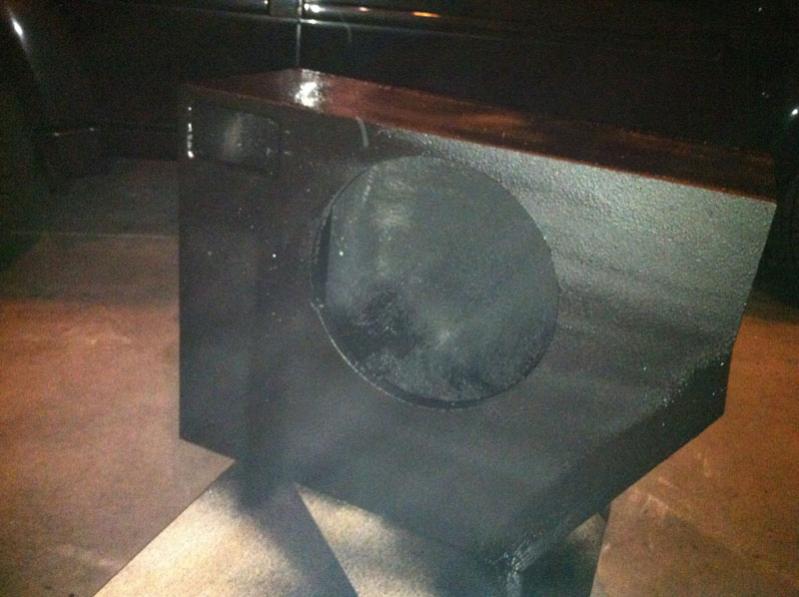

    I made some more progress on the sub enclosure yesterday.
    I chopped the side of the box off and gave it a test fit before sealing it up. I will have to re-route the factory wiring harness up the side (a simple zip-tie job) but all in all its an easy fit.
    Back in the garage, I sealed up the side, cut and installed the port, and put another several coats of truck bed liner;
    2013 Outback V

    Ian,
    Did you lengthen the port accordingly after modifying the enclosure?

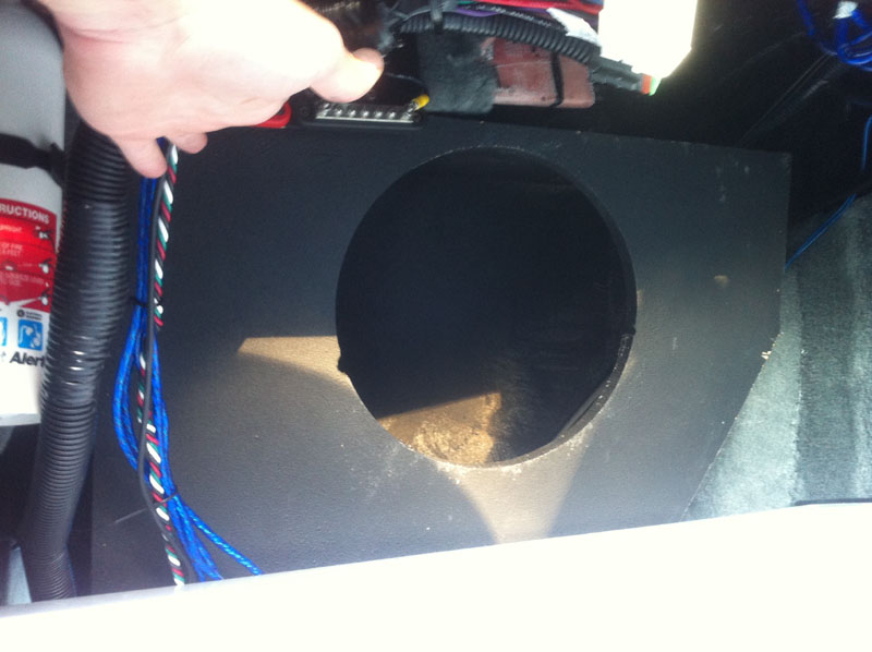

  10. #100
    7,491
    how about the sterring cable etc. i am interested on how you move the center hole conduit for wiring ballast and sterring cable
    here is my pic
