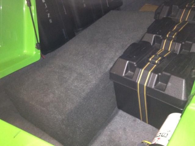

    Now I seem to suck at taking pics once I'm having fun but I got a couple. Here is the 1100 filled up. Notice the water in the bag is level and boat is leaning haha.
    Getting the wake dialed in has been a learning curve, and with different people/loads its always changing. Its nice to be able to drain and fill while under way. For wake boarding I like the bow sac fairly full and anywhere from 300-600lbs. in each rear locker, always more on the riders strong side.

    I'm upset I didn't get one of the surf set up. I had a hell of a time getting it to surf. The hull changes in '08 are obvious because I have friends surfing behind newer ones with a lot less weight. So I finally pulled the 1100 out of the starboard locker and put it on the floor next to the seating on the port side. I still was able to use my port pump and hose to fill it due to my superior planning during install (haha). With the 1100 full on the floor it pretty much fills up the entire carpeted area around the stadium seating. I filled the 1100 in the port locker and the bow sac and went surfing, now she surfs! I plan on going out tomorrow and will finally make a point to get pics. Shouldn't have problems leaving my phone on the houseboat!
