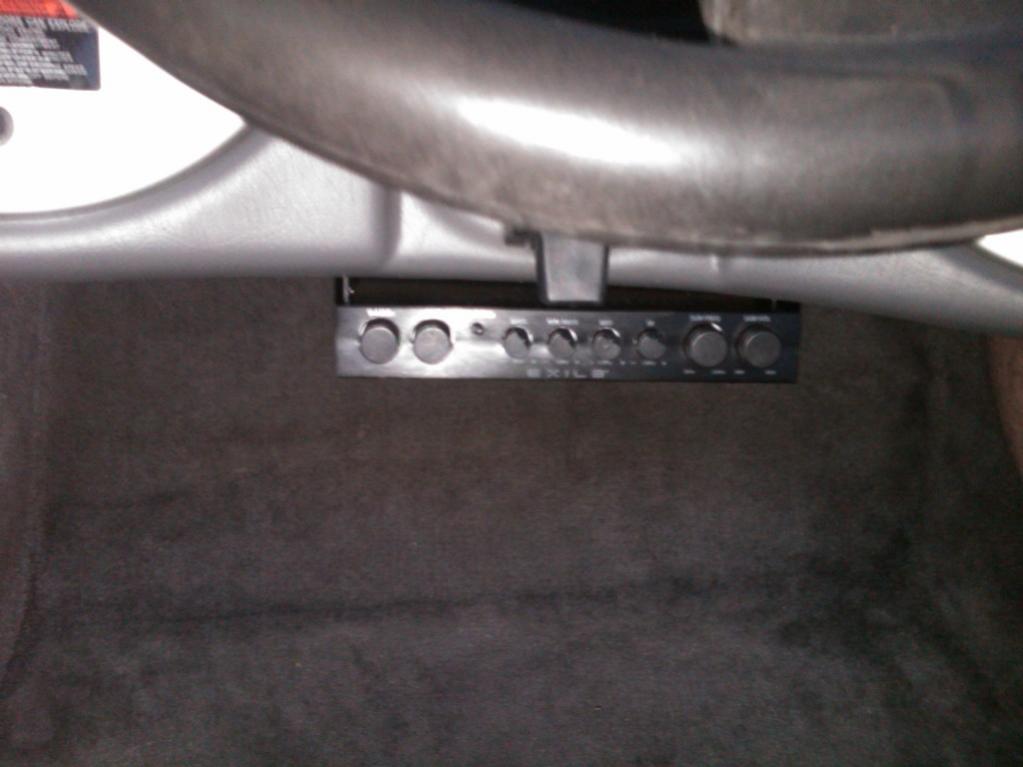

    I just ended up doing my krypt eq this past weekend.
    Did what was suggested above. Cut a piece of 1/2 inch plywood just slightly wider than eq, bolted it below the oem switch panel on right side with 2 L brackets, mounted eq to board and also attached a piece of wire to the board near the rear to stop any movement up and down on big waves etc, it's solid.
    7,271
    here is the pic
