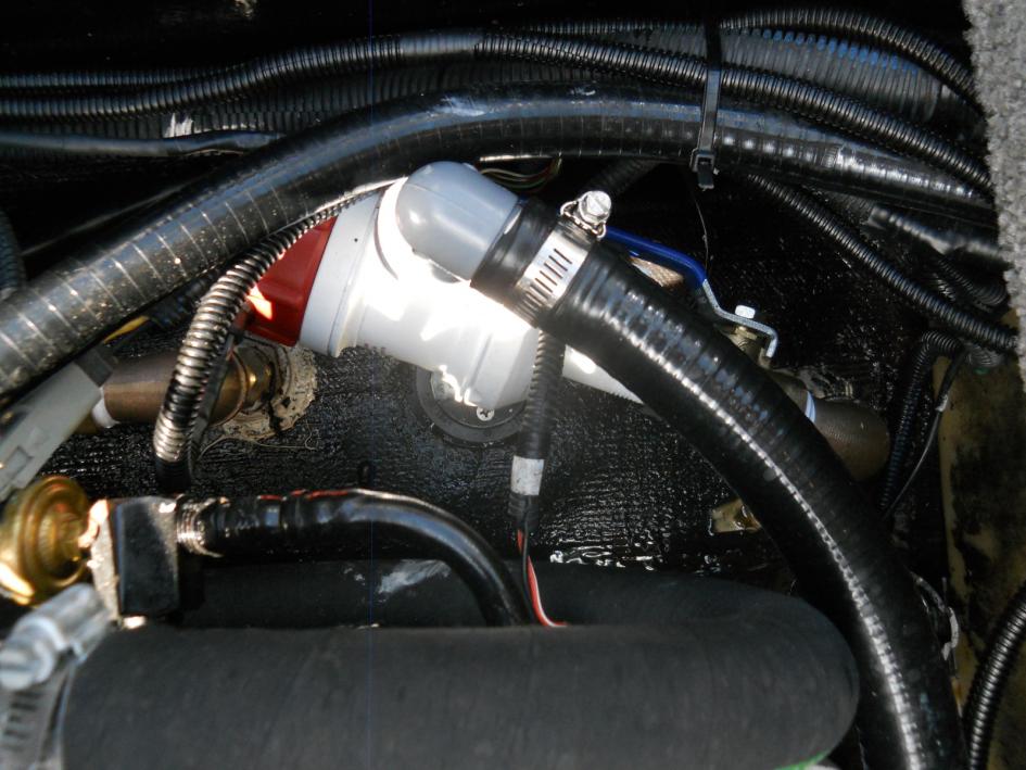

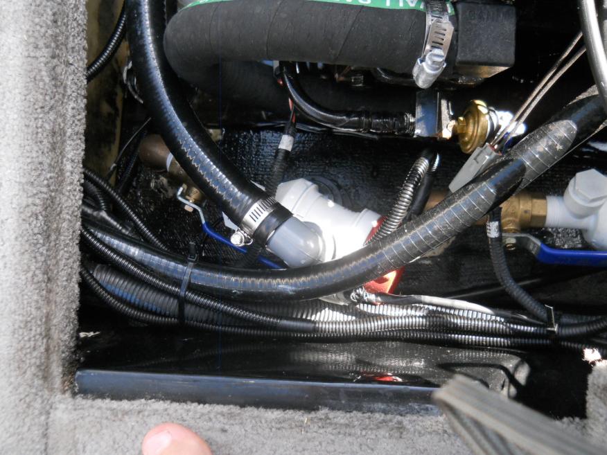

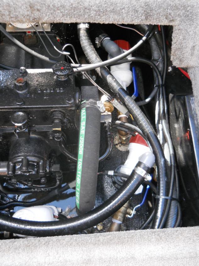

  8. #18
    Kerr Lake, VA via Durham, NC
    80
    Here are some pictures of the two pumps we added. The thru holes are on either side of the paddle wheel and the one closest to the bow is beside the depth finder (I think that's what that is).
    I moved the drain pumps in the rear so that the outlet of the pump is facing upwards. Haven't had a chance to test it on the water yet unfortunately.
