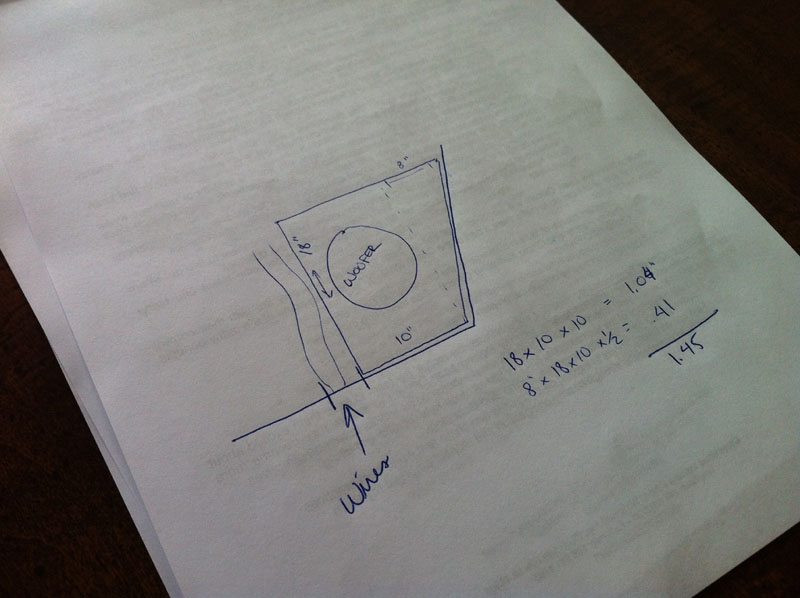

    What was your initial plan, to do like 24" wide, 18" high, and 6" deep? With all the space behind that seems like kind of a waste.
    Looking at the picture and using my guesstimates for measurements, I'd do this;
    Trapezoid shaped box;
    Bottom length: 10"
    Height: 18"
    Top length: 18"
    Depth: 10"
    This will give you 1.45ft^3 before material thickness and driver displacement, likely getting you right where you want to be in the end.
    That's what I'd do, final answer (that is if you don't go ported.)

    But Ian, given your diagram isn't the mounting of the sub going to be off center? I'm assuming that the top length and right side is hugging the interior wall of the hull? So the sub would be more at your right leg?

    JM, that's the reason mine is designed the way it is, I also wanted the sub in the center. This is all I could come up with to have it centered with the steering wheel.
