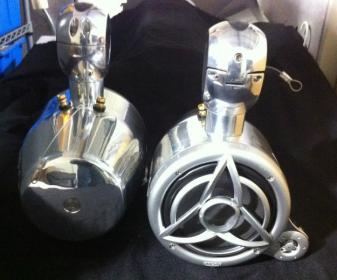

    Hey guys. This is only my second post, but I spend a lot of time on the forum learning from you guys so thanks in advance. I am hoping to replace my tower speakers, but still use the stock Roswell cans that the Kicker factory speakers are in. I want to get something decent up there, but can't go too crazy yet as I want to keep my current amps. Long way of saying I am not ready for the EXILE path, just had a baby. Today I have a ZX 700.5 powering my cabin speakers(6) and a 12" Kicker sub. The two tower speakers are the stock kicker components in the roswell cans. They are powered by a kicker ZX 250.2. I was thinking i could replace the speakers with the Polk DB 651 or DB 6501. If i used the coax's instead of the components I would just leave the kicker tweeter grill on the cans and cut off the wire. Any thoughts on if there would be any issues with this change out? In particular I am concerned about size and power concerns. Also, I have been toying with the idea of adding set of polk DB 691's as a supplement to the two already there. With all polk DB on the tower would my amp be strong enough to power all 4 speakers very well? How would I need to change the amp set up to get the most power out of my tower? Thanks for any help you can provide. Also open to suggestions on other replacement speakers to consider that would fit the existing cans, either coax or component. The picture is not of my actual speakers but they look identical to these ones.

    There is a Kicker HLCD speaker that, I think, drops right in those cans. I'm sure David or Phil can tell you all about it. Probably what you are looking for.
    13,423
    I think its the Kicker 6500.2. I'm sure you can find them cheaper, but you get the idea:
    http://www.crutchfield.com/S-TIJ3xHg...-KM6500-2.html
    Another thought is to give Brian a call at Exile. He can be very helpful in fitting you to your needs without breaking the bank. I'm sure he has some stuff lying around in a box that would work for you. Can't hurt to call him and tell him what you are after. He's a true pro. Gave me great advice about where to start so I could easily add to my system when I was ready.

    I don't like to mix speakers of different sizes on the tower if I can avoid it. Why? Larger speakers play louder, right? That usually leaves the smaller speakers less audibly visible while they are still consuming an equal portion of your limited amplifier power. So there are more effective routes.
    Your amplifier will deliver a premium in power (but not actually double) if you lower the impedance by running two pair of speakers in parallel and four speakers will certainly play louder than two.
    Now here is one thought. If you can find a Kicker two-channel amplifier identical to the one you have now then you will have a great start on a lasting and permanent tower solution with 250 watts per side. That is enough power to run one pair of any larger HLCDs or substantial surf speakers in the future. You will not be limited in your future speaker selection by power limitations. This way you are not investing in anything that you will have to replace later.
    Many on this forum will share how they made a short term decision and ending up spending more in the long run when they were displeased with the performance. Very small HLCDs and automotive speakers on the tower rarely last for long as they are frequently upgraded.
    So form a concrete vision of what your final solution will be and build it incrementally with zero turnover of future product purchases. I know sometimes its difficult with a nickel burning a hole in your pocket now.

    Thanks guys for all of the advice. I will try isolating the short tomorrow if I don't see a stray wire or what not causing the short near/at the amplifier. I am really excited at the idea of hearing my system in whole for the first time once I get this sorted out. Might have to roll the boat down to a stereo shop for a full tune once I get it all working too. David, I like your idea about 2 big tower speakers instead 4 small ones. Just reinforces that a pair of the XM9's are what I should be holding out for. By the way at $1100 I will probably move those to the next boat instead of "trading them in". I will let you guys know if I am successful or if I need some more advice.
